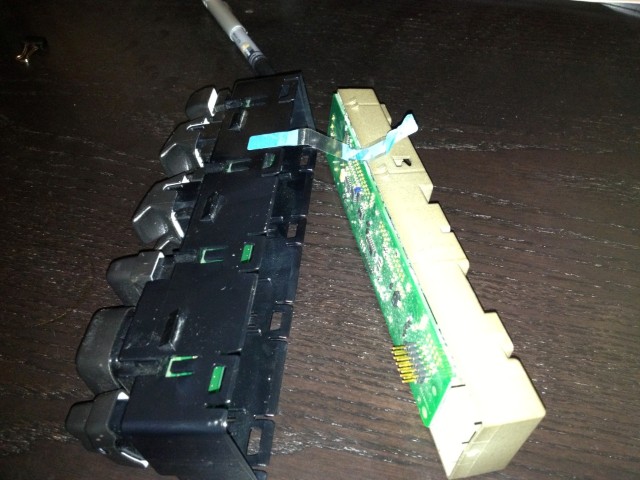

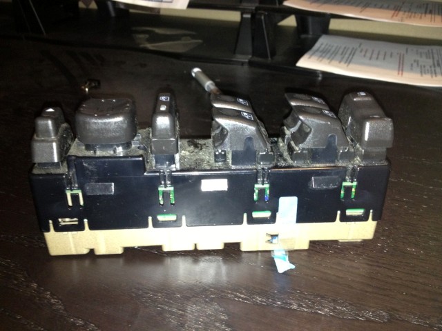

pdxrealtor 11-04-2012 02:51 AM
Re: Seat heater
2 Attachment(s)
Can you look at this parts diagram and description and tell me if you think that would include the complete assembly?
I'd hate to end up with just the switches that attach to the casing the circuit board it in.
http://parts.nalleygmc.com/showAssem...modelYear=2006
EDIT--- On a 2003 Yukon I was told the switch and DDM are sold as one unit. I also can't seem to find the DDM as separate unit.
SO... I'm thinking that this must come as one unit.
Here's a couple pics. I don't see any damage or corrosion to the DDM board.
Attachment 54110
Attachment 54111
pdxrealtor 11-26-2012 12:34 AM
Re: Seat heater
DDM module, pictured above, and problem is solved.
Thanks for all of your help!
