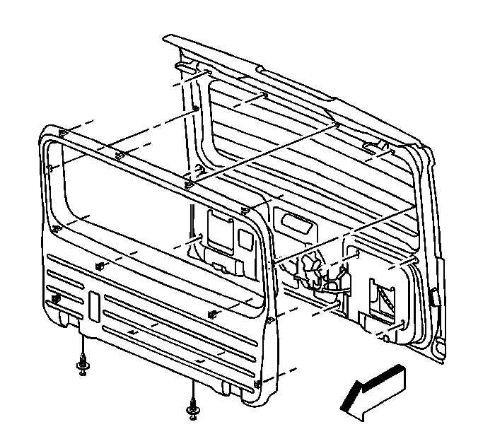

Is this what you want? Note pull strap removal procedure is trivial. And numbering got a little messed up when I pasted it in here.
Document ID# 840810
2003 HUMMER H2
Trim Panel Replacement - Liftgate
Removal Procedure
Attachment 33070

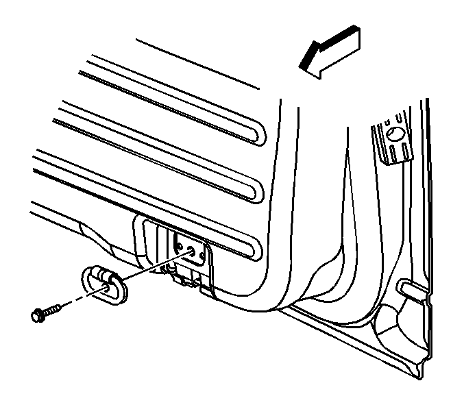

  1. Remove the lift gate pullstrap. Refer to Pullstrap Replacement - Liftgate .
  2. Remove the bolt that retains the cargo tie down
Attachment 33071
  1. Remove the 2 push pin fasteners at the bottom edge of the liftgate trim panel
  2. Gently pull on the lift gate trim panel to disengage the retaining clips.
  3. Remove the lift gate trim panel from the vehicle.
  4. Inspect for broken or missing retaining clips and replace the clips as necessary.

Attachment 33073
  1. Install the cargo tie down and secure with the tie down bolt.
    Tighten
    Tighten the bolt to 9 N?m (80 lb in).

JetEyeNite 11-17-2006 04:18 PM
Re: How to remove Rear Cargo inner panel??
ree,
Yes... that is exactly what I was looking for... Thank you very much.. :)

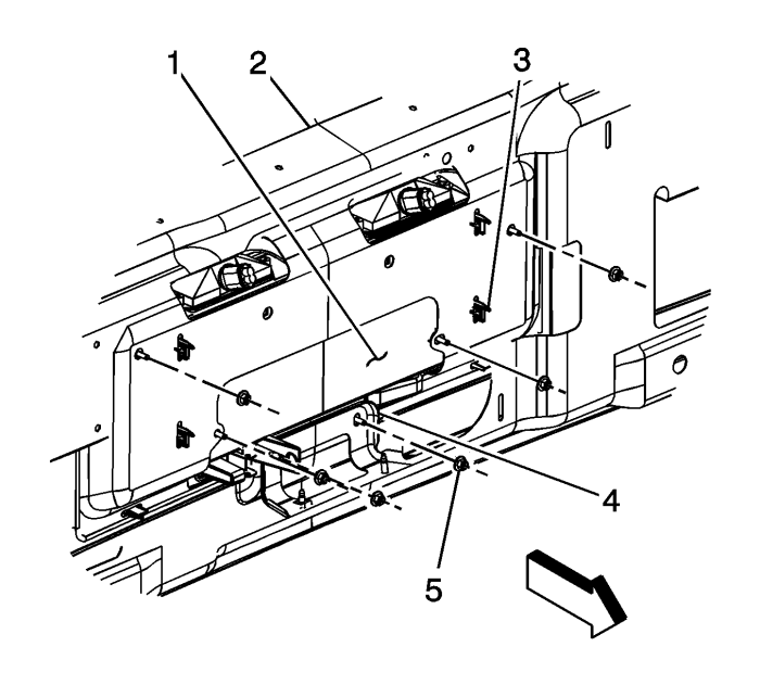

I have a similar problem with the license plate holder, it's coming loose at the top and appears a mounting boss is broken inside.
The problem comes from the door supports, once it's near closure they allow it to slam shut which stresses that panel. I just haven't had the time lately to take it all apart and fix it properly.

Same problem here. I was thinking of just putting some new double sided tape on the liscense plate holder, maybe it will work.
REE, do you have a diagram of the liscense plate holder assembly? thanks

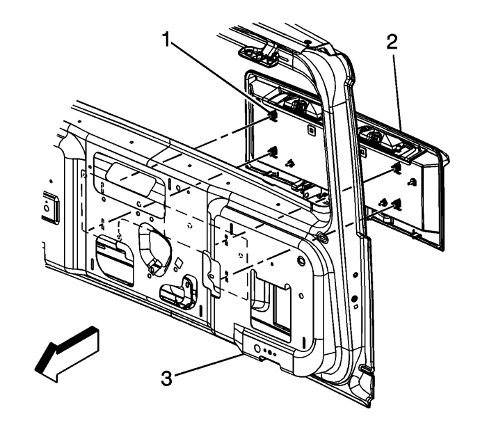

ree 11-18-2006 11:12 PM
2 Attachment(s)
This is all I can find.
Attachment 33107
Attachment 33108
