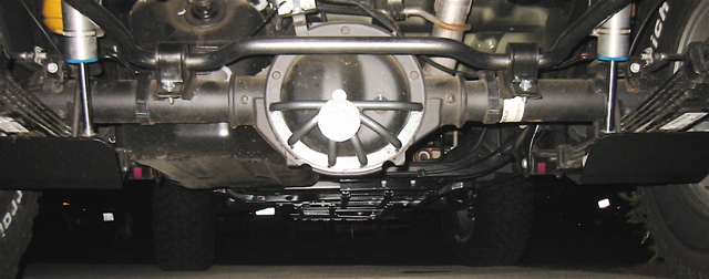

Stayed home tonight and turned wrenches. Spider Diff. Guard, Hunner Skids, Fox Shocks, Hellwig Sway Bar... and up front GM Undercarriage Protection. Tomorrow I'll go try it all out. Good night.
jmsspratlin 07-14-2007 11:08 AM
Re: New Undercarriage Pro
Very nice, I really like the Differential Guard. Never seen one before:beerchug:

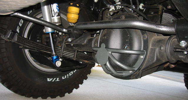

Diff Guard is from http://purplecranium.com/wsm/i-385_h...er_spider.html
Best 80 dollars I have spent, so far.
Here is a better pic? From this morning.
bjc 07-14-2007 04:09 PM
When you installed the half-spider did you just pull the bottom bolts and install the spider or did you remove all bolts, cover, drain fluid, and then reinstall and refill.
My spider came in, but I don't have any fluid sitting around and I wasn't sure whether the bottom bolts could be removed without any leakage.

trailerpup 07-15-2007 02:26 AM
I only have 3000 miles on my H3. So, I just removed the bottom 5 bolts and put the spider on there... no runs, no drips, no errors. I think the pumpkin cover is RTV'd at the factory.
The beefy Hellwig sway bar is 1 1/4 inch (some sales sites are calling it 1 1/8 inch, but it is 1 1/4). It came with poly bushings for the front sway bar, too. It makes a huge difference in the body roll I was experiencing in rear with the stock set up.
The only drawback is that I haven't gotten the parts together to make my own quick disconnects, yet. I really wanted the "orange" Amstar Disconnects (not because of the color, but because they are made for the H3 and look beefy), but who knows if they are every going to sell them. So, I am still deciding on which disconnects to modify. I am looking for this Ipe extend travel thread to see what he used. Anybody have any suggestions.
Now all I need is the SAW T bars and Samco Shackles to arrive in the mail and I am done with the undercarriage/suspension.
Next up, finishing up the stereo/nav install. Got my JL Stealthbox the other day, and I am tracking the "monsoon" rear quarter panel through UPS. Should get here during next week. I'll post pix, of course!
Took the rig out today. Didn't really hit any "real" rock crawling spots, but did some "high speed" washboard passes. Wow, I feel like Rod Hall, all of the sudden! The Fox shocks were really eating up the bumps!! I ran some of our normal trails up here on the way to rock climbing this afternoon. Didn't even come close to hitting anything... when I got home my camera was sitting on the table, patiently waiting for my return. Dooh!
I didn't think I was going to like the Hunner shackle skids, but now that they are on there, I dig 'em.

Yeah, the spider is way-cool, huh? I have been running the same trails since I got my H3 a couple months ago with the stock sway bar attached. A couple weeks ago I disconnected it and tied it up out of the way. It makes a huge difference with it disconnected. The new sway bar has been sitting around waiting for me to make some disconnects before I put it on. I finally just threw it on there cause I was bored and wanted to turn some wrenches. I am planning on getting some disconnects next week and modifying them next weekend. This is my daily driver, and the first thing I noticed was how much body roll there was in the rear while driving around town. The new sway bar has eliminated the body roll. But, I still want more articulation for the trails. Hence, the HD sway bar and disconnects. Does this make sense? :o

Nice upgrades, everything looks sweet. Was the sway bar a straight bolt on? Or did it require any modifications?
trailerpup 07-16-2007 03:33 AM
The swaybar is a direct bolt on. It took less than 15 minutes. You need the correct size allen wrench for the "link" bolts. The "tricky" part will be fabbing up the disconnects.
