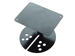

I mentioned this on another thread so I figured I oughtta post up some details. ;)
I used the bracket from Off-Road-Only to mount the plate to the spare tire.
Attachment 42196
I used Lite N Boltz (bolts with LEDs in them) to light the plate. Probably not legal in CA. :shhh:
Tapped into the existing plate wiring, ran it up behind the taillight, into the tailgate and out the vent. I added a quick disconnect so everything can be easily removed to get the spare off.

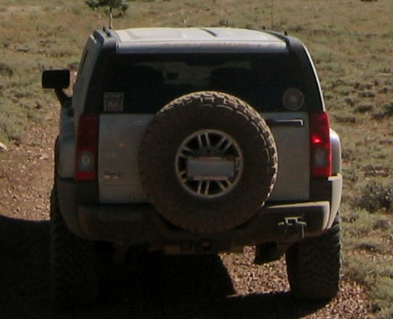

Couple pics of it installed.
Attachment 42197
Sewie 07-30-2007 05:10 AM
Re: License plate relocation
As I mentioned in the other thread, there's no mounting points behind the bumper on the left side so I couldn't add another d-ring. At some point I'll get a plate welded on the frame rail so I can add it.
