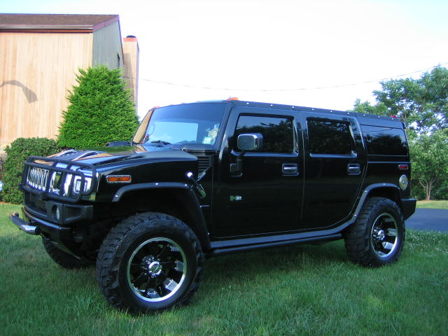

I put in the cognito idler and pitman kit
cranked the torsion bars using stock keys
added Bilstein extended shocks
I have the air suspension so I also did the reversing of the bolt so it doesn't get caught on the large tires.
i did 20" with 37s - no rubbing at all
Attachment 43310
Cesardajr 09-06-2007 07:15 PM
Re: question about leveling kit
hum good
are your running 12.50 or 13.50 wide tires to get no rubbing?
HUM GOOD 09-06-2007 08:58 PM
they are 13.5, but I compensated with my off set to get a full turn out of them
