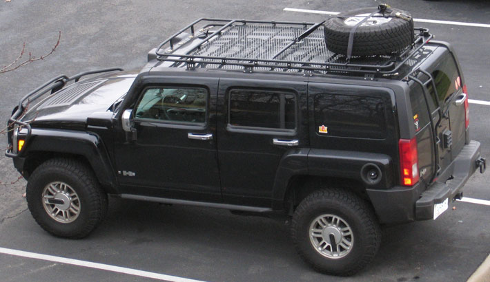

Gobi Stealth Rack - full size:
Attachment 45193

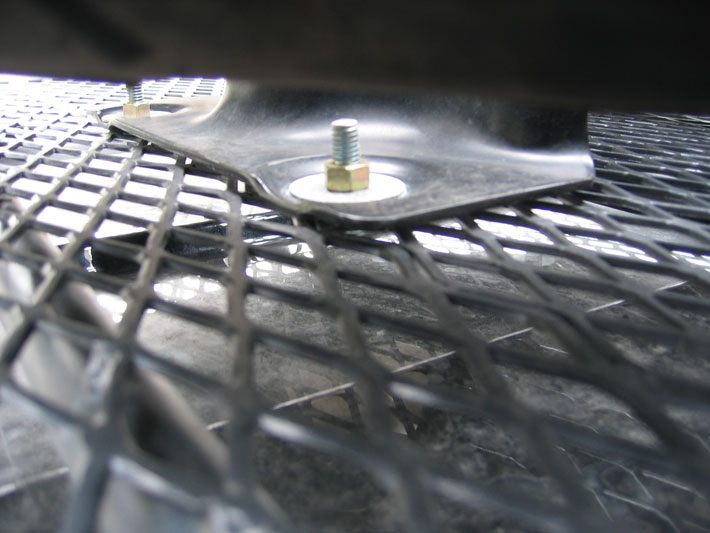

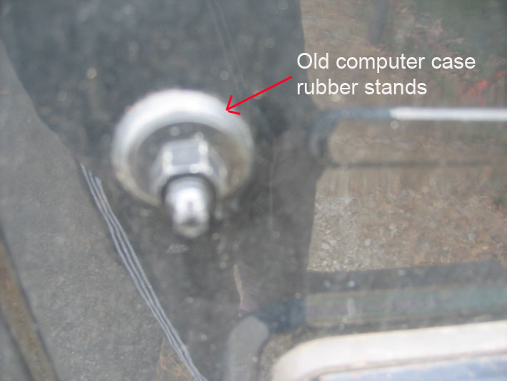

1st off I pulled the spare and bolted tire mount. Once the bolts are removed, they expose 4 holes and the machine drilling of these holes are not accurate, there is a gap between the body and door frame. So I took 4 rubber skid stops from an old computer case and spray panted the existing door bolds black to match my paint job as best as possible:
Attachment 45200
Attachment 45194

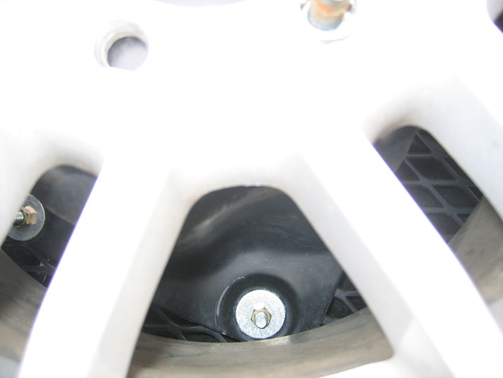

Next I moved the mount and used 8x 2 inch steal washers and 4 bolts w/ nuts and secured the tire mount to the gobi rack heavy duty steal mesh:
Attachment 45195
Attachment 45196

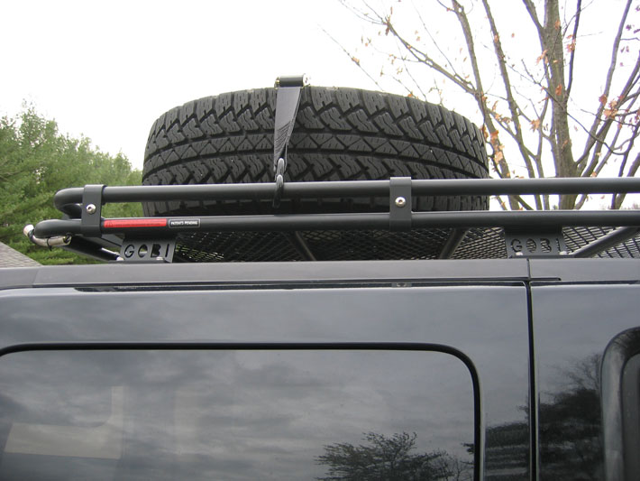

I decided to add a 3,000lb cargo strap to secure any vibration the tire may produce when driving:
Attachment 45203

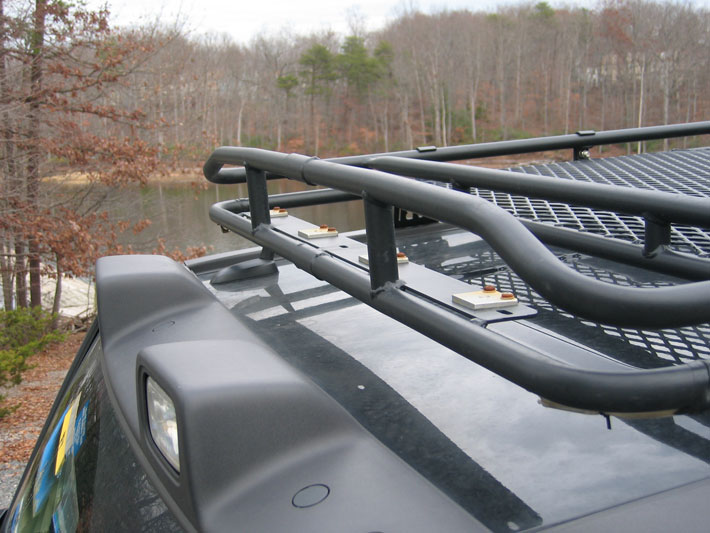

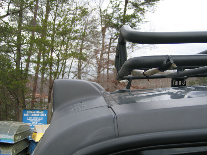

Also, I could not add the wind flare to the front of the rack because of my road lamps, but as you can see, there is plenty of room and for XM/Onstar:
Attachment 45206
Attachment 45207

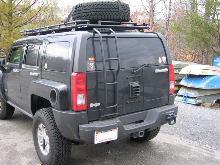

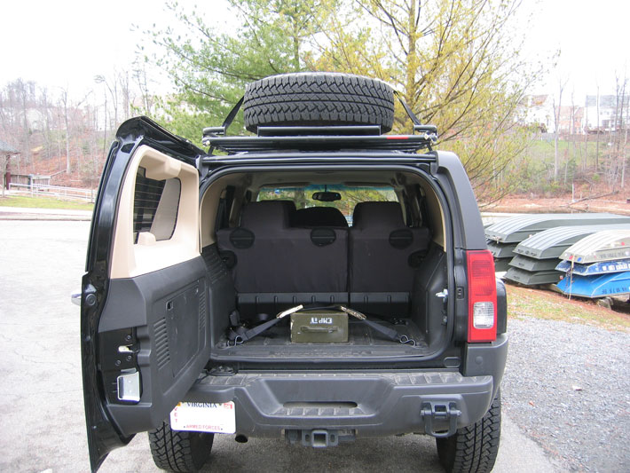

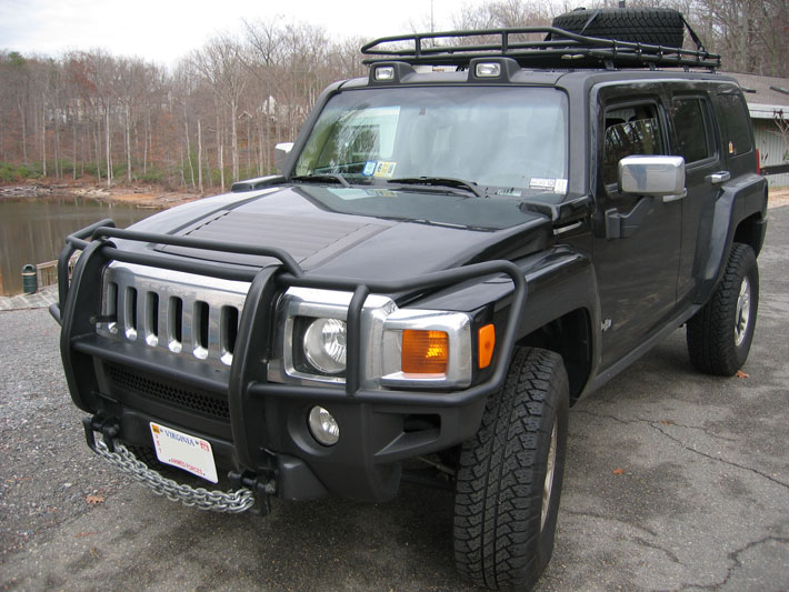

End product:
Attachment 45208
Attachment 45209
Attachment 45210

I really don't like the bare back door exposing the cabin exhaust and mounting bolts. I think my next step is to find a mount for a jerry can and use the pre-existing bolts to mount it. They'll be able to handle the weight with no problem.
Example:
Attachment 45227
