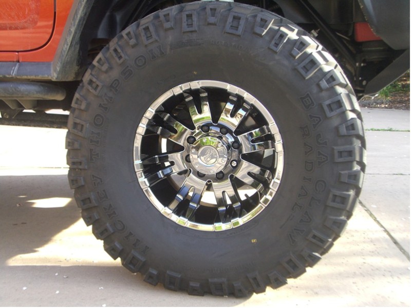

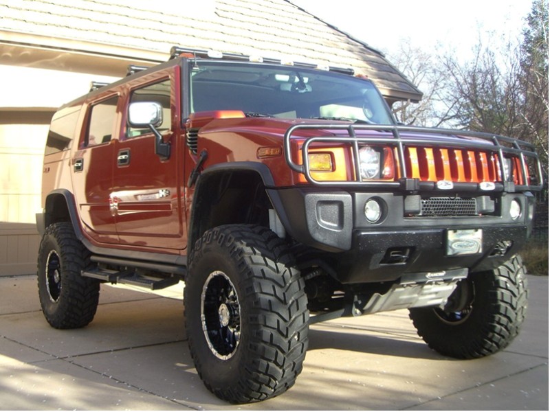

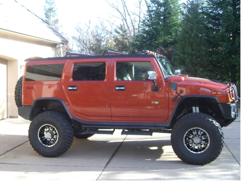

Just upgraded my rims and tires yesterday and this thing is a beast now. I bought the Supermaxx torsion keys and rear coil spacers from Trail Duty to give me some extra clearance. Tires do not rub at all. I haven't taken it offroad yet but I like the look. I previously had Goodyear 37" MTRs and got 45,000 miles out of them. Wanted to try something different this time.
Attachment 46853
Attachment 46855
Attachment 46856

Sweet looking truck! How many more inches of lift did you get out of the spacers and keys? That looks much more like 6 inches of lift than 4!

I have the Rancho lift on my H2 and love it. Prior to adding the torsion keys and coil spacer, I have put my H2 next to my friends H2 that had the Fabtech lift the they were within 1/4 in of each other in height. The coil spacer added 1 1/2 inches in height and the torsion key add the same amount. Easy to install, it only took 2 hours to install the parts.

Looks mean but judging from the closeup pic I would say probability is high of severe rubbing and maybe tearing your fender wells.

Wheels are 18x9.5 with a 4.5 backspacing.

I have no doubt you will rub though. I had 37 13.50 with that lift with the same offset/backspace rim. At full flex it would just clear and in some cases you would get some rub. You may wnat to check that out thoroughly before you go offroad.

Just got back from the Norcal Hummer Group snow run and the setup worked perfect. No rubbing at all. With the additional 1.5" lift from the Supermaxx torsion keys and coil spacers everything cleared no problem. I will post some pictures when I can. These tires worked great in the snow, way better than my MTRs ever did.

How do you like supermaxx keys with rancho lift I have same lift but I would like to have little more lift at front.

I've had the keys on for about a month now and so far everything is great. Ride quality is unaltered and installation was a piece of cake. It only took about 2 hours to lift both the front and the rear. You need to realign the front end once the torsion keys are installed. I drove around for a for a couple of days to make sure everything was settled in prior to realignment.
