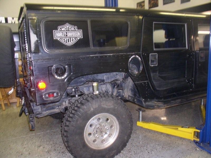

lvs 04-19-2008 01:42 AM
Re: Lift kit
1 Attachment(s)
Harely Dave, you haven't broken anything yet because you haven't been off-road since you had it installed. Ok, maybe you did a little, but not enough!!
FYI - I just got done having the Alpha rear close out pannel installed after a 2" body lift. It does not fit exactly. It had to be trimmed quit a bit around the mid section. Looks pretty good though.
