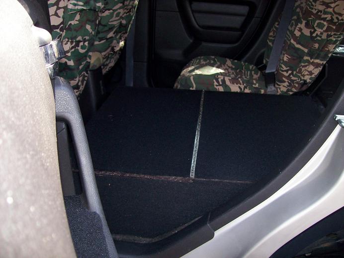

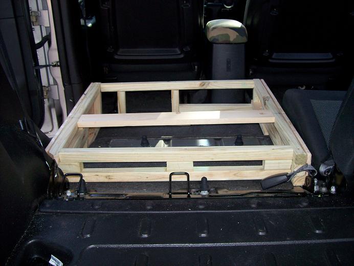

This is my original setup for my dog.
I only can fit 2 people .
fourfourto 04-10-2009 03:09 PM
Re: 3 Seater/Sleeper H3 Conversion
9 Attachment(s)

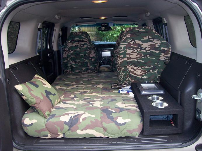

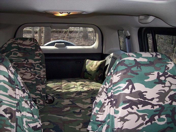

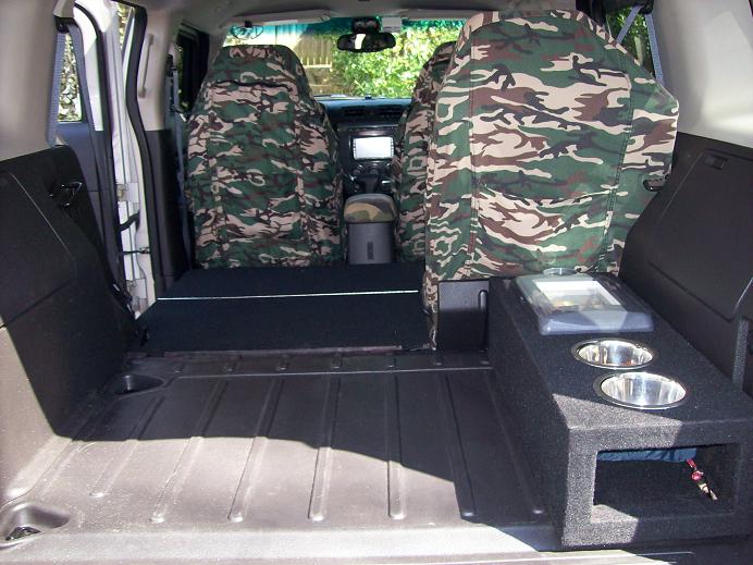

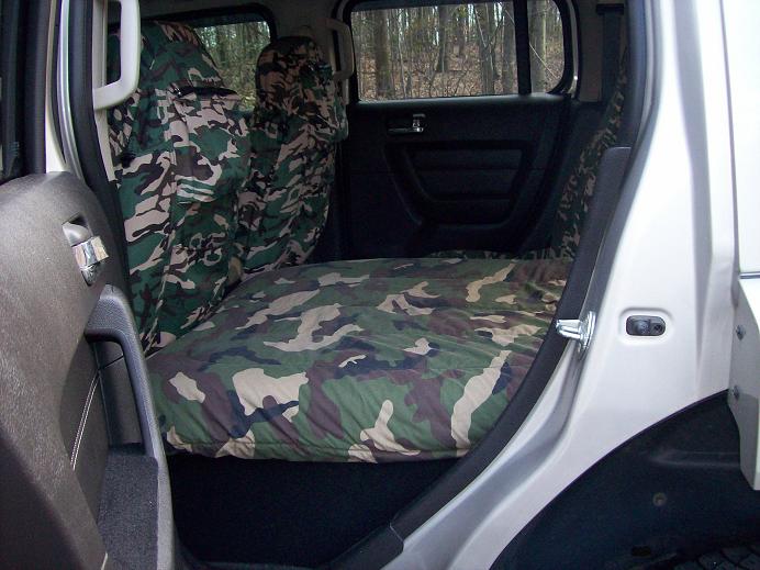

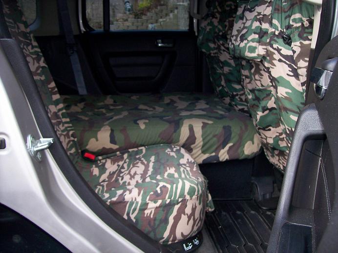

Now I can fit 3 people and take a nap in the back (or banging :D )

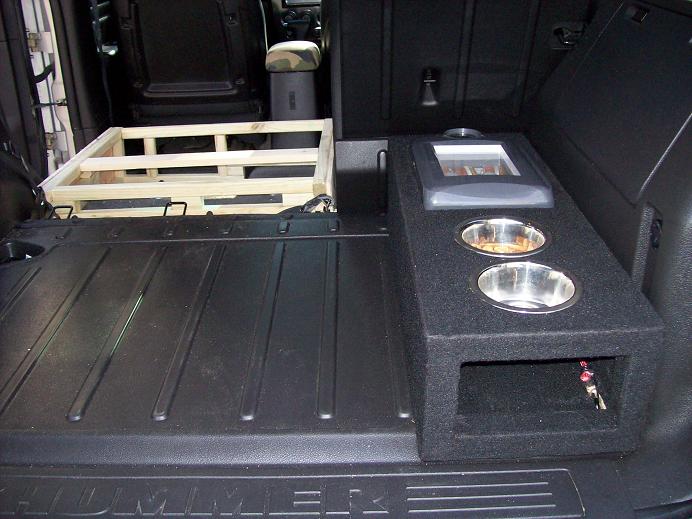

I used 2x2 1x2 3x1 and 1/2 plywood for the frame and covered in speaker box carpet.
I had a extra 3 inch X apx 6 foot matteress(they sent me wrong one with camper and told me to keep it ... FREEBEE !)
My dog likes the exra room and it will come in handy for my road trip to NM in may/june.

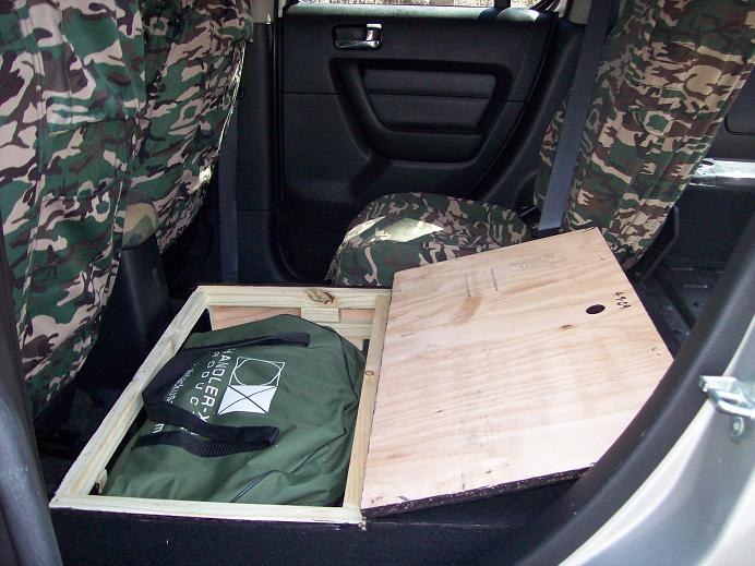

I store my exaust jack under the hinged top.
Attachment 50794
Attachment 50795
Attachment 50796
Attachment 50797
Attachment 50798
Attachment 50799
Attachment 50800
Attachment 50801
Attachment 50802

That looks great!! What do you keep in the box in the back? Is that a cooler tucked in there?
fourfourto 04-10-2009 05:38 PM
Its a 12 volt mini fridge(also heats)Powered by relay through ignition wire
Theres storage under dog bowls,(windbreaker) jacket.
Ill end up filling that space.
