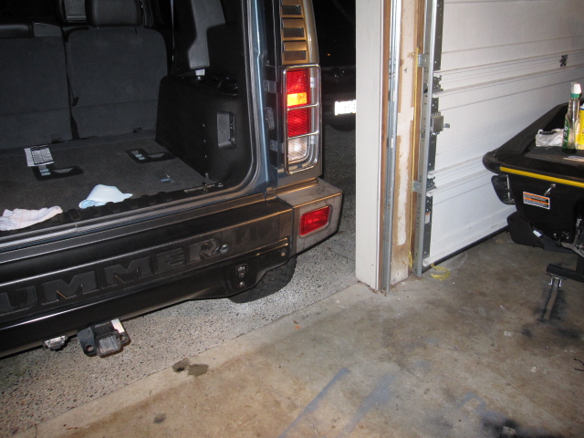

The spare tire removal is done (with the exception of still needing the tow hook attachments--PM me if you have any)
I used GMparts direct to get a replacement license plate pocket that has the plate lights in it. Did you know you can get an all black one? This was a nice find for me, the all black, because I really didn't want that chrome strip across the top of the pocket.
The installer used the original spare tire wire harness and the same connection point. He then ran the wire up the wheel well into the back passenger side of the HUMMER, the side behind cowling and into the lift gate.
While doing the pocket, I had a back up cam installed along with a coastal tech universal lock pick. The truck now pops the cam on when the car is in reverse, or at any time I push the button on the remote control.

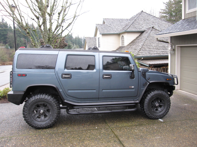

pdxrealtor 01-19-2010 10:29 PM
Re: My HUMMER progress thread- spare tire removal, light bar/lights, cameras, ETC!
6 Attachment(s)
Attachment 52152
Attachment 52148
Attachment 52150
Attachment 52153
Attachment 52151
Attachment 52149

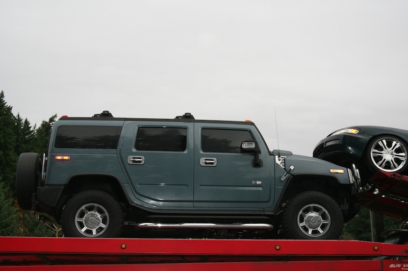

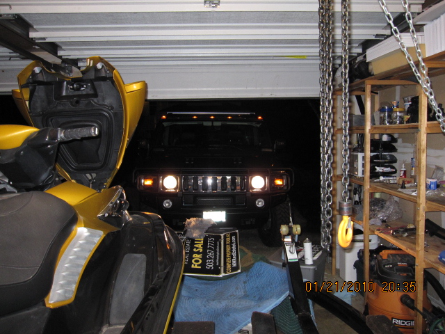

pdxrealtor 01-19-2010 10:35 PM
1 Attachment(s)
Back up cam with night vision...

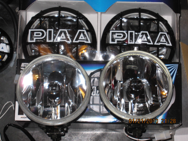

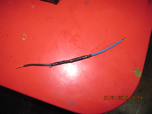

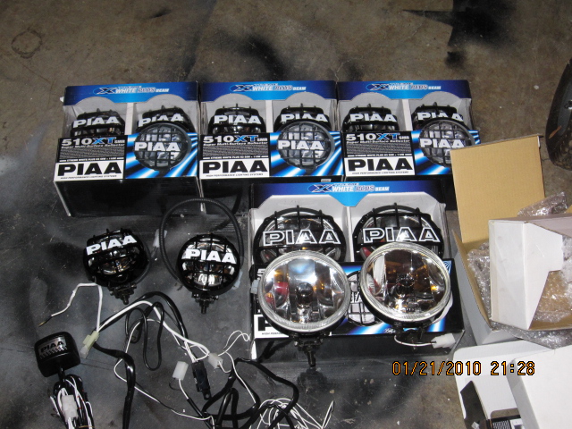

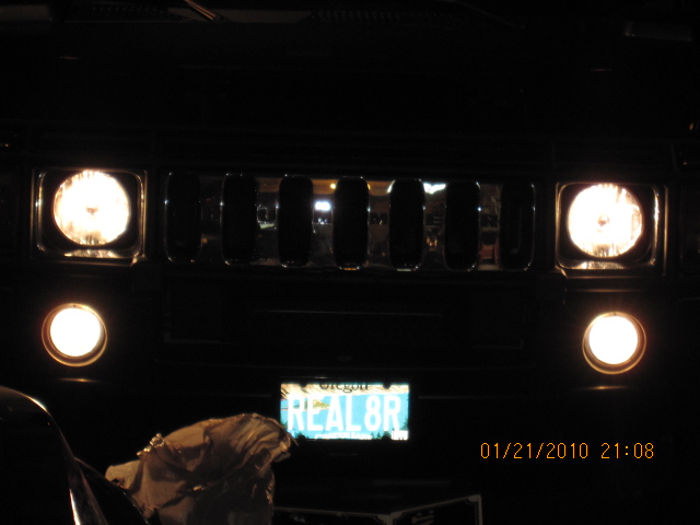

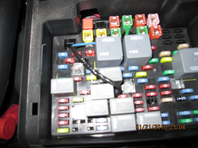

pdxrealtor 01-22-2010 05:59 AM
DRL mod done! Silverstars In! PIAAs!
7 Attachment(s)
Got my "light box" today and already got busy.
Did the DRL mod w/resistor and put silverstars in both the headlights and the DRL... huge improvement over OEM!!!
I snapped pics of the jumper wire... you can see I used a blue wire and a black wire. The blue wire simply represents the striped side of the resistor.
Also pictured are all my PIAAs! I got eight 4" 510 SMR driving lamps for the roof cross bar that will soon be called my light bar! :D
Also I got 2 PIAA 520 SMR fogs for the brush guard.. PIAA had some old FOG SMR lenses laying around (very hard to come by) which are also pictured.
My new cross bars are on the way, for a total of four. I have 2 ideas for mounting the eight 4" SMRs but need to actually get a cross bar on the ground to see which way I'm going to go.
More pics and info as things come together!
Attachment 52159
Attachment 52160
Attachment 52158
Attachment 52157
Attachment 52162
Attachment 52161
Attachment 52163

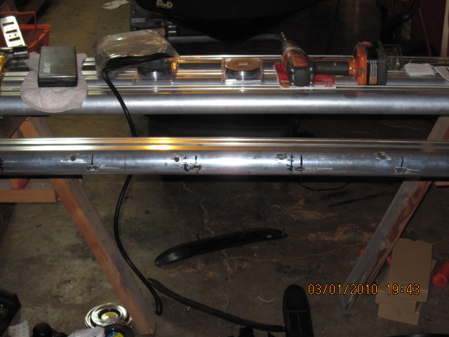

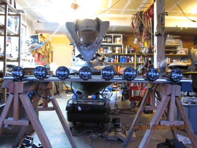

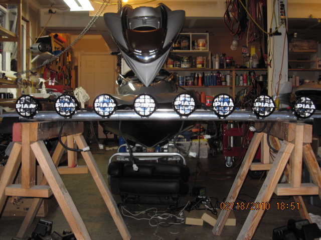

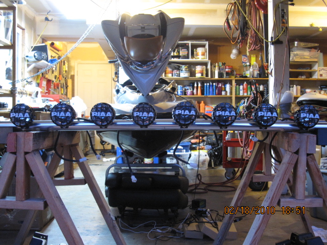

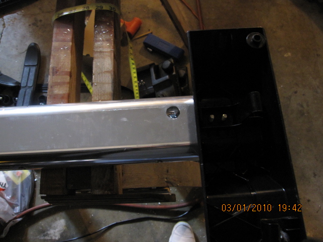

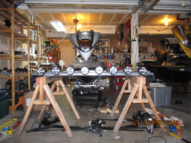

pdxrealtor 02-19-2010 03:38 AM

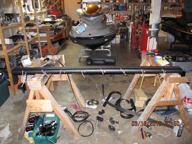

4 Attachment(s)
Finally got the light bar started... I have to drill the hole and fit rubber grommets for the wires off each light and then it'll all be off to the powder coater.
I know the light bar wires need to come out on the driver side, but a side from that I haven't a clue how to route them on the inside of the cross bar.
Anyone have any suggestions ????
Here's some pictures--
Attachment 52278
Attachment 52279
Attachment 52277
Attachment 52280

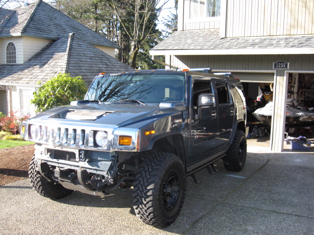

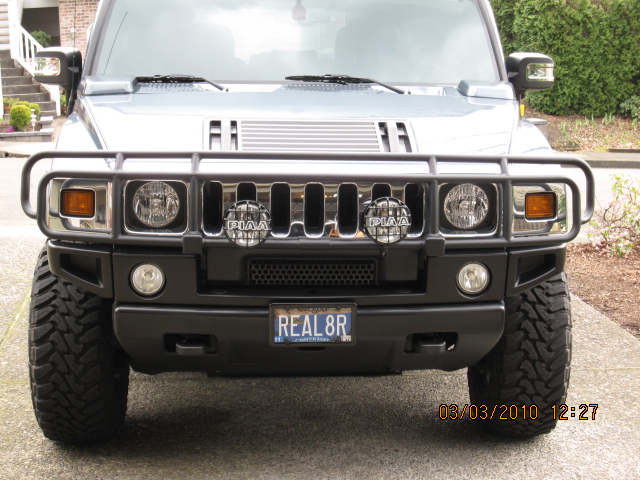

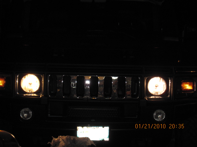

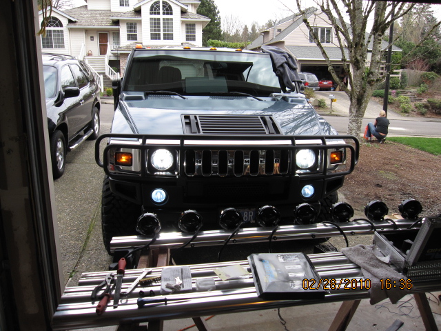

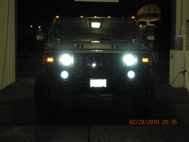

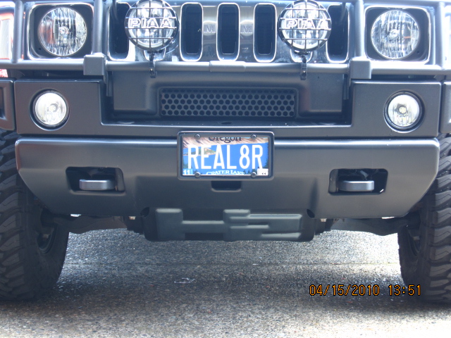

pdxrealtor 03-04-2010 06:13 AM
5 Attachment(s)
Been doing work here and there.
The sliverstar headlights just don't cut it!!
I've got the PIAA fogs installed and wired up, and I added HID headlights and LED DRL. The LEDs I got from retro solutions (same place as the HIDs) and are the best match I could find. I tried several bulbs from PIAA to generic in an attempt to better match the HIDs. No go!
The skid plate is off and is headed to the powder coater with the 4 cross bars ( one will be the PIAA light bar) and my aftermarket nerfbar steps.
The raised H2 portion of the skid plate will be powder coated to match the slate blue. ;)
Here's some pics... nothing major.
One thing I will say is that no matter how hard I tried I could not get the HID headlights to show in picture form the way they really look.
They look much better and cleaner (not a bunch of hot spots) in person.
Attachment 52335
Attachment 52334
Attachment 52333
Attachment 52332
Attachment 52331

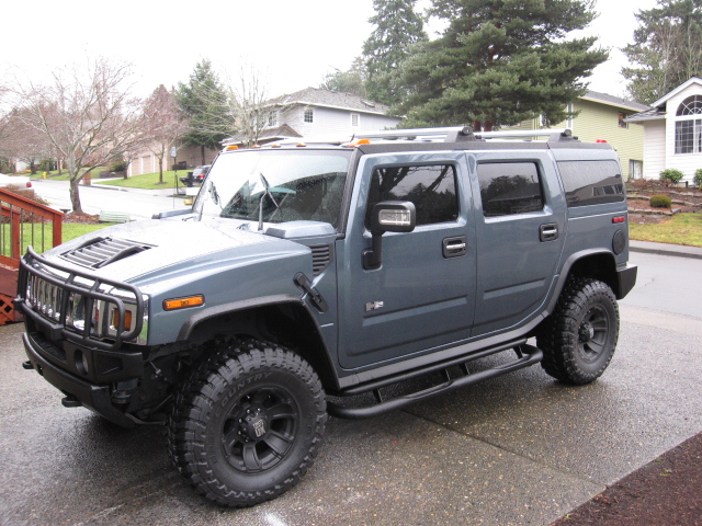

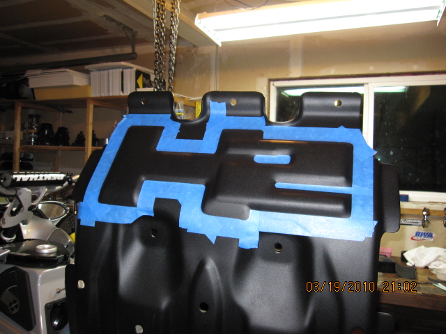

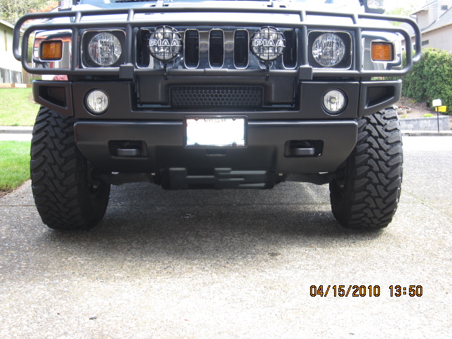

pdxrealtor 03-20-2010 05:36 AM
4 Attachment(s)
I've made lots of progress and getting really close to being done.
The cross bars and other items are back from the powder coater, I got new wheels, and the light bar is all wired but the lights aren't bolted up yet.
Here's a couple pics.... I'll be picking up the paint to do the skid plate on Monday. The raised H2 will be the same color as the truck.
The pic with the new wheels really doesn't do the truck justice... it was a crappy day out.
Also, the black roof crossbars really make a huge difference (no pics at the moment). I can't believe how much it really balances the entire package.
Attachment 52418
Attachment 52420
Attachment 52419
Attachment 52417
