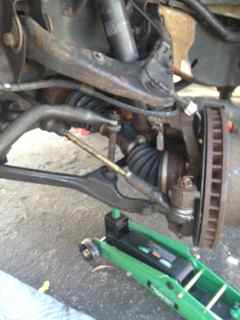

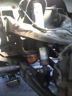

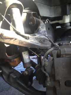

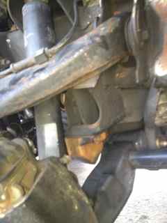

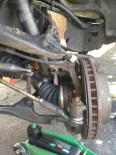

Originally Posted by Indy
Check the clearance on the front upper metal bump stops. If you are touching them with the upper a-arms, then you don't have any downward flex. Also, did you install extended shock brackets up front? And don't forget, coil spring suspension is a bit harsher than the air suspension and if you crank the front, you also stiffen the suspension a bit.
i took some pics to show you
Attachment 53753
Attachment 53755
Attachment 53756
Attachment 53752
Attachment 53754
cecil-1 02-25-2012 01:17 PM
Re: ROUGH RIDE AFTER COIL SPRING INSTALL
in the third pic it looks like the upper control arm is sitting on the frame stop.
check and see if it is. That would deff cause your rough ride. I had the same thing happen when i cranked mine up. Replaced them with the cognitos and that fixed the rough ride and the alignment shop could get the alignment back in specs.
whitehummer 02-26-2012 05:21 AM
They are resting on frame. I started replacing the ball joints today and thought that might bring them up a bit but not enough I'm sure. So what exactly are you suggesting I do? Thanks
