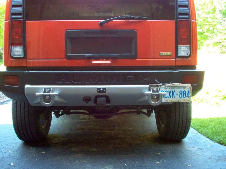

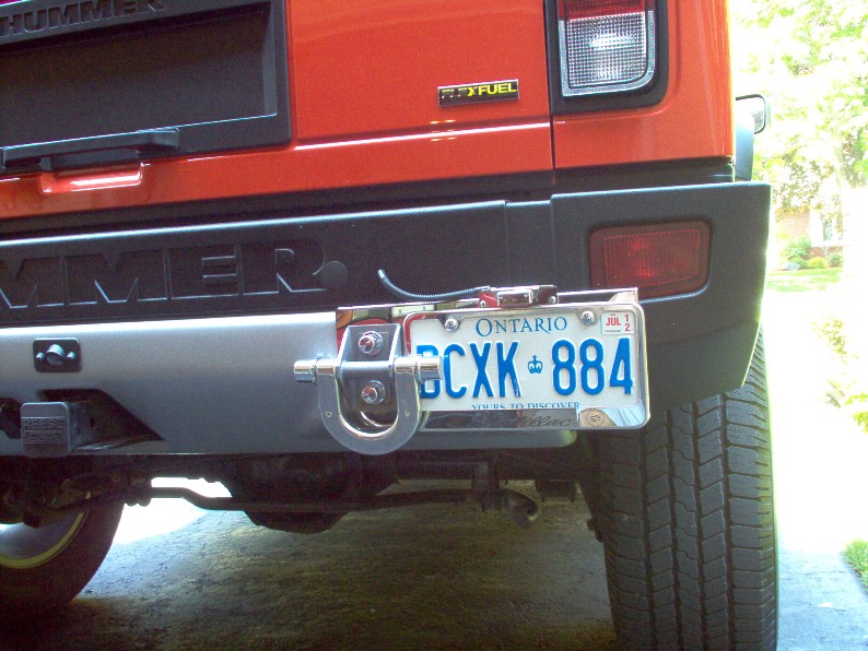

My 09 H2 was bought with the rear tire carrier removed.Clean look at the back.I just got the truck last fri,and noticed where they put the licence plate,the right back tow hook bolt completly blocks the first letter of the licence plate.I told the sales guy that is a good reason for a cop to pull you over for that.He then said the owner of the GM dealership bought the truck for himself in 09 and removed the spare tire carrier from day one and never got stopped by the police ever.I am still a little leary of having the plate like that.I live in London,Ontario,Canada and the city cops here just look for a excuse to pull you over.I like the look of the licence plate going in the black center square where the rear hatch release is.Only one thing,just wonder how many H2s that have it back there have a plate light there.Last question is the mounting of it.Do you line it up and just drill plate holes through the gate,and bolt it on.Hopefully someone here that has put the plate there can give me some tips on the best way to do it.Or,is putting the plate in another spot easier.I am open to all options.

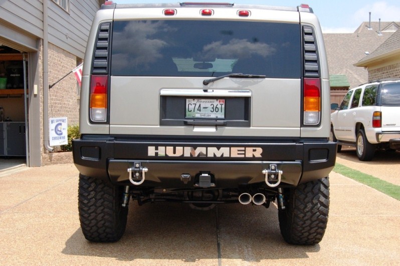

The models that came with the interior tire carrier had a different rear pocket that had a light. Here's an image of an 05 http://parts.nalleygmc.com/showAssem...modelYear=2005
I'd be a little leery about that plate too. They look like aftermarket tow hooks...the stockers would not block the plate as much. If you keep your rear pocket you could just drill some holes and bolt the plate right up...of course you'd be running without a light, and that could be just as risky as blocking the plate with that massive bolt.

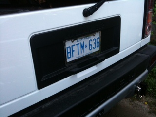

Hi i looked at it about 2 years ago when he had it for sale, they wanted to much at the time. I bought a white 2008 for alot less, it had 20,000 km more on it than that truck did then. I did change my 2008 plate here is a picture it has a bright led light at the top.
Attachment 53826

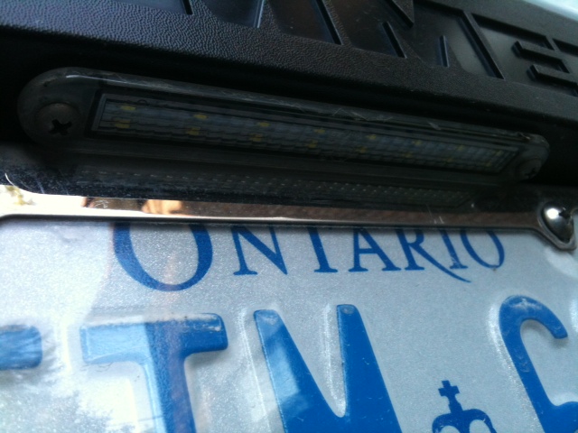

Attachment 53827
Hi the led light is countersunk so it looks factory, also around here if the cop wants to he can give you a ticket for it being cover up abit. I hope you got the spare tire carrier and the spare tire even if you don't use it.

Hi i installed it myself,i milled the holes for the lic plate and the light at the top. I also used a factory gm weatherpack plug and tapped { soldered} into the clearance lights so if you ever need to change the led it just unplugs, i think it took me about 4 hours start to finish. I bought the led form a local parts store i deal with i can't remember the brand name. Be Glad you got the tire and carrier because it nice to have and cost alot!!!

I have the same spare tire eliminator kit and you can remove the bolt caps from the tow hooks and it would make the plate a lot more visable.
