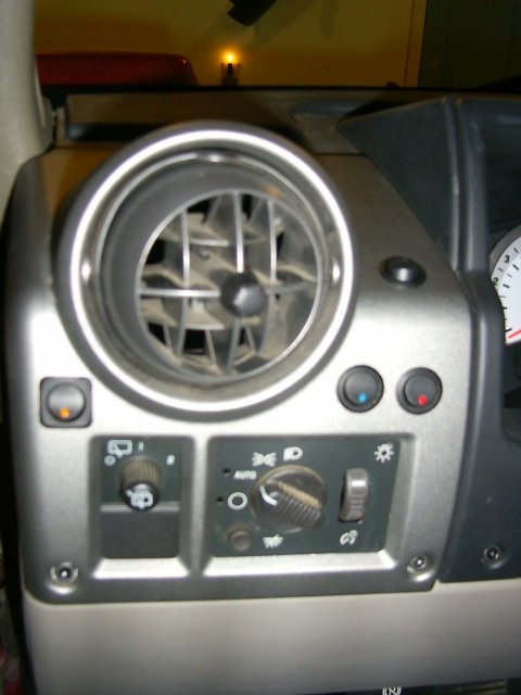

I will take a pic of mine tonight and poat tomorrow...I have placed 4 swithces in the left air vent cap area and they are great. Easy to drill holes with a wood bit, and very easy access to wire behind. One for the brush guard lights, one for roof rack forward lights, one for roof forward/side angle lights, and one for the rear ligts.

Here is the dash with the 4 switches added
Orange/left for rear roof-rack lights
Blue/center for brush guard lights
Red/right for forward roof-rack lights
Green/top for magnetic mount side lights
Ric
OMAHOG/IHOG/MHC
Hum2@cox.net
www.OMAHOG.com

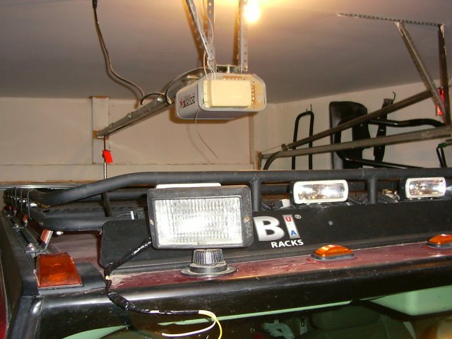

Hum2 is off the scale
2
3
