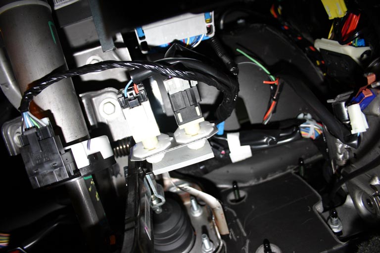

Here's a shot under my steering wheel. Hummer Customer Care said that my towing package did not come with the hookup under the steering wheel, and that I would have to hardwire it. That seems really silly, although I can not locate where I would connect the break controller too -- so it looks like I will be running a wire to the 7 pin outlet.
08-23-2005, 10:02 PM
Ok, I'm not getting anywhere. I don't know how the wiring is done in the rear. Maybe check with f5fstop to see if he can find it on the H3 service info.
BTW, what is that red or orange wire that looks cut
