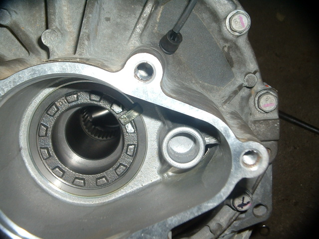

Did you you get you front locker installed before the run friday? Put mine in on saturday. Must say the IFS front is a pretty easy install, but the generic instructions supplied by Eaton are for rears and kind of leave you in the dark on where to break the wires out of the case on a IFS front. Get the hole off a little and the wires could rub against the ring gear bolts. A picture would have helped the first time. Hope this pic helps the next person doing first their one.
