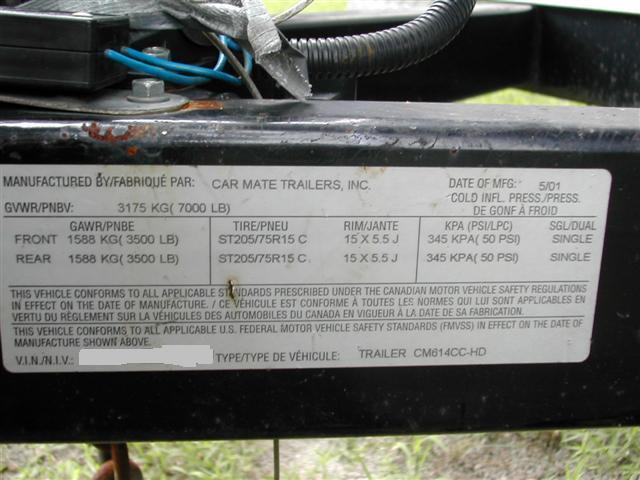

Attached is a picture of the info on my box trailer, based on all I have read on the forum, I assume GVWR (7000 lb) means it’s over weight for the Hummer? What I don’t understand is how this trailer weighs almost as much as the H2…. That is if I am reading the label right….

<BLOCKQUOTE class="ip-ubbcode-quote"><font size="-1">quote:</font><HR>Originally posted by JMV1210: What I don’t understand is how this trailer weighs almost as much as the H2…. That is if I am reading the label right…. <HR></BLOCKQUOTE>
JV- That tag says what the trailer is capable of hauling "7000" lbs. , not how much it ways . Its saying each axle can haul 3500lbs. , so the trailers total capacity is "7000"lbs. minus the suspended weight which is everything above the axles. Trailers own weight above the axles is probably around 1000lbs. . So you can approxiamatly hual 6000lbs on the trailer deck and your total gross weight will be 7000 lbs. which is all it is recommended for. Doug

<BLOCKQUOTE class="ip-ubbcode-quote"><font size="-1">quote:</font><HR>Originally posted by PARAGON:
An equalizer hitch is not necessary if you have the air suspension. They serve the same purpose. The weight distribution design will not be utilized (no weight on the bars) because the truck will keep the rear end level. <HR></BLOCKQUOTE>
I disagree wholeheartedly. Towing a heavy trailer will eat through a limited slip as fast as anything you can do. The weight distributing hitch takes the weight off the axle where as the air suspension just compensates with stiffness. I would use the weight dist setup every time if you ever plan to wheel that thing.
Old 01-28-2005, 05:43 AM
Superman Superman is offline
Posts: 35
Superman is off the scale
<BLOCKQUOTE class="ip-ubbcode-quote"><font size="-1">quote:</font><HR>Originally posted by Dug3x3:
JV- That tag says what the trailer is capable of hauling "7000" lbs. , not how much it ways . Its saying each axle can haul 3500lbs. , so the trailers total capacity is "7000"lbs. minus the suspended weight which is everything above the axles. Trailers own weight above the axles is probably around 1000lbs. . So you can approxiamatly hual 6000lbs on the trailer deck and your total gross weight will be 7000 lbs. which is all it is recommended for. Doug <HR></BLOCKQUOTE>
GVWR means gross vehicle weight rating. It is a function of adding the two axle ratings together (manufacturers fudge this for registration purposes) and it represents the vertical load that the axles are capable of carrying. It has nothing to do with a trailer, it is payload only.
The trailer weight that you can pull is your GCWR: gross combined weight rating. It should be listed in your owners manual.
edit: I see, I was looking at that like it was the vehicle tag. You still need to look at what you have available to you. Do not evceed your GCWR in your owners manual (if you get in a wreck, your ins co. may shut you down) and pay attention to the hitch rating (on the frame). I would be surprised if your frame hitch is rated that high without w/d. most are not.
Trailers own weight above the axles is probably around 1000lbs. <HR></BLOCKQUOTE>
If you ever get weighed (which I have been, but on a commercial basis, it will probably never happen to you) they throw the scales on the ground so figure an addtl 500 lbs at least for the axles.

<BLOCKQUOTE class="ip-ubbcode-quote"><font size="-1">quote:</font><HR>Originally posted by Superman:
If you ever get weighed (which I have been, but on a commercial basis, it will probably never happen to you) they throw the scales on the ground so figure an addtl 500 lbs at least for the axles. <HR></BLOCKQUOTE>
Superman - Yes, i should have told him to add the axle weight into the equation in case he gets weighed. I was just giving him a low down on what the trailer tag meant. Doug
