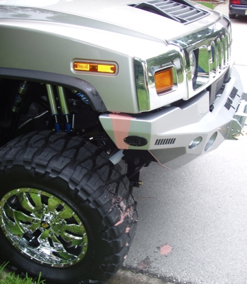

Looks like your sporting some Road Armor there. Nice Hummer from what I can see .

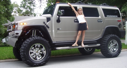

Yes, the trans fluid is over full, it still looks clean, not milky but thin.
The flat bed picked it up about two hous ago
I am still in the process of customizing it and I will post pics and details at a later time, (like when I can drive it.)
Thanks for the info

OK...Just a peek
Rick S. Bohler

Very nice rig!!

Thank you!

I have to agree... A very nice looking ride...
