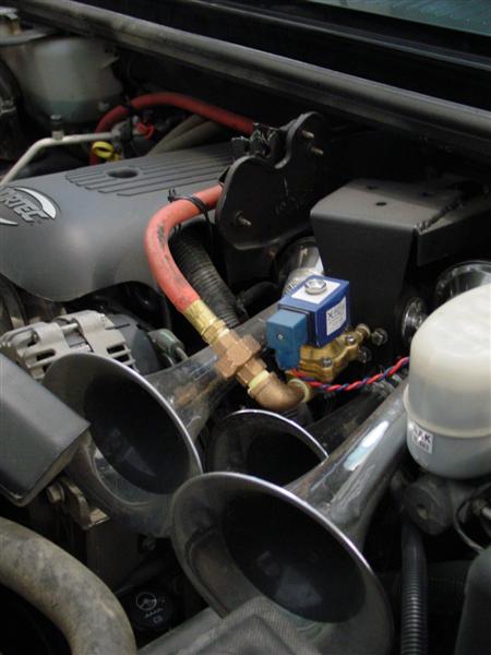

Few things - I made my own bracket for the horns by welding angle iron onto the existing bracket. You'll have to do something similar if you want them under the hood. It's a very tight fit but it can be done. Also, I have the compressor & tank mounted in the jack compartment in the bed. The jack is now under the back seat.

Old 01-22-2006, 08:39 PM
Dan Dan is offline
Location: Cognito
Posts: 2,155
Here ya go, here is the horn installation. If you want a compressor/tank pic let me know. It's pretty much self-explainatory though.

Here ya go, here is the horn installation. If you want a compressor/tank pic let me know. It's pretty much self-explainatory though. </div></BLOCKQUOTE>
Man, that's tight in there under the hood. But it is out of view so it won't draw the attention of a LEO looking for any excuse to hassle you.
