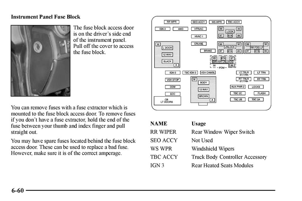

I just ran a diagnostic check with my Superchips programmer, and got the follwoing codes:
#1) P0740 - Torque Convertor Clutch Circuit Malfunction
#2) P0785 - Shift Timing Solenoid Error
I'm on my fourth of many beers to come, gonna drown my sorrows.

<!DOCTYPE HTML PUBLIC "-//W3C//DTD HTML 4.0 Transitional//EN">
<HTML><HEAD><TITLE>Service Information</TITLE>
<META http-equiv=Content-Type content="text/html; charset=iso-8859-1">
<META content="MSHTML 6.00.2900.2802" name=GENERATOR></HEAD>
<BODY bgColor=#ffffff>
<FORM name=topNavForm action=/servlets/CellHandler>
<TABLE width="100%" align=center>
<TBODY>
<TR>
<TD width="25%" slign="LEFT"></TD>
<TD align=middle width="50%">Document ID# 828044
2003 HUMMER
H2
</TD>
<TD align=right width="25%"></TD></TR></TBODY></TABLE></FORM>
<HR>
</FORM>
<H1>DTC P0740</H1>

The torque converter clutch (TCC) solenoid valve is an electrical device that
is used with the torque converter clutch pulse width modulation (TCCPWM)
solenoid valve in order to control TCC apply and release. The TCC solenoid valve
attaches to the transmission case assembly extending into the pump cover. The
TCC solenoid valve receives ignition voltage through the Ignition0 voltage
circuit. The powertrain control module (PCM) controls the solenoid by providing
the ground path on the TCC solenoid valve control circuit. The PCM monitors the
throttle position sensor voltage, the vehicle speed, and other inputs in order
to determine when to energize the TCC solenoid valve.</P>
When the PCM detects a continuous open, short to ground or short to power in
the TCC solenoid valve circuit, then DTCP0740 sets. DTCP0740 is a

Inspect the IGN0 fuse for an open.</P>
Refer to <A
href="http://127.0.0.1:9001/servlets/CellHandler?CellId=62113&amp;RefDoc=828044&amp;evc =sm">Circuit
Protection - Fuses</A> in Wiring Systems.</P>
Is the fuse open?</P></TD>

Location: CSA
Posts: 2,511
Just for grins, I'd check the "IGN 0" fuse.

Thanks very much, Klaus...you are indeed THE MAN!
I checked the fuse, it's good. I'm still under warranty, so I'm not too concerned.
