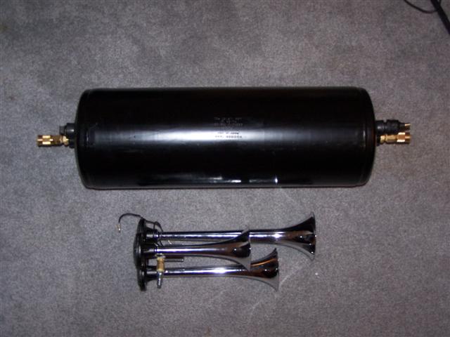

The "Inner Tim Allen" in me has surfaced again. This time during an air horn installation.
The roots of this one lay in the end-of-trail event all H2 owners know: The 20-40 minute tire refill.
After blowing about 45 minutes airing up... I began the search for a better way. I found that most 12vDC air pumps only put out around 10L max.
Knowing there had to be a better way, I tapped into my friends in south china an found it. I found a shop in south china that makes a 150L per minute air pump. It runs on 12vDC and draws about 60 amps.
So of course... I ordered one.
Then I thought about it and decided that it would go even faster if I have an air tank.
Having just installed the Gobi rack... I had lots of space up top.
Knowing I was thinking of installing an air horn, I called and asked what size air tank was suggested. The horn vendor sugegsted a .5 gallon tank.
So I bought a 5 gallon tank. I figured a 900% reserve couldn't be a bad thing.
I also bought a Viair 145 psi pressure switch.
And a set of horns....
I spent the better part of tonight fabricating a mount to put the horns in a semi-protected place on the Gobi rack.
The black spray paint is drying on the new mounts right now.
I'm going to run 3/8 hose from the tank to the horn. I hope it can breath through that...
Report on the expected carnage tomorrow after parts are dry and installed....

Cool Charles, what kind of horn did you get?
</div></BLOCKQUOTE>
I found the manufacturer of this horn setup in China. The horn was rated for 100 PSI.
I talked to them real nice, agreed to buy 3 cubic meters of them if they would:
Make mine in 100% chrome
Upgrade the valving to handle 150 PSI
Guarantee 152DB+ (yeah, like I can actually check this number....)
And ship me a sample now!
The did all three... which is why my horn has black paint on the valve bodies.
I will have just a couple feet from the tank to the horn... and its 3/8 hose. It should hurt pretty good when it goes off. To get some extra slam I might replace the existing solenoid valve with a 1/2" valve I have here...
We'll see...
When I go home today I'll mount it up and see how it all looks...
In short: Horn- Chinese mystery Brand X "Ningbo Special"
Tank - Hoosier Tanks
Pump - "The Monster 150L/min" Southeastern Shanghai Custom Pump Works... some guy named Tony (No joke)
This thing better go boom...

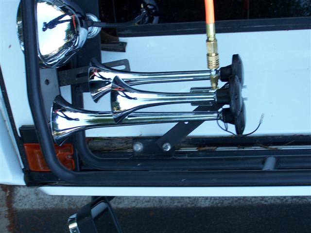

Progress pictures...
Here is the horn. I made a mount from two metal straps and then bolted it to the Gobi rack. (Yet another way the Gobi rack makes life easier...)
As you can see... the hose routes over the sunroof. So later I will make another trip to the hardware store to buy a 90deg elbow and a close nipple to allow me to shoot the hose straight backawards and not over the sunroof.

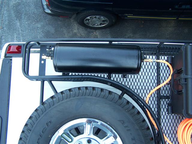

Here is the air tank. I attached it to the mesh in the floor of the Gobi rack. I made two backing plates then threaded bolts through the feet of the tank, the mesh, and finally the backing plates.
The tank mount is very solid. Teh size should allow me to run air tools and also let people know when I am really upset in traffic.

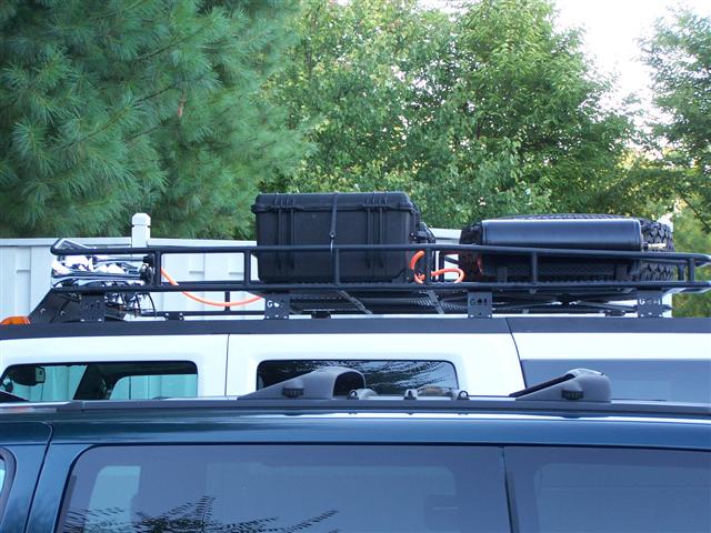

Side profile of the horn and tank on the rack.
