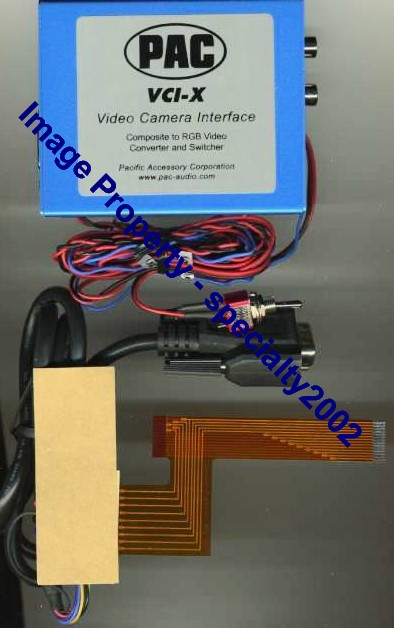

Does your adapter look like this?

thats it

I installed the VCI-GM1 adapter because I don't have a touch screen. My adapter has the mini toggle switch so I can switch to back-up view any time I want. As far as the reverse trigger wire, that is in the junction box under the dash by your left foot. I believe it is a light green wire.
2003 Pewter, SunRoof, Nav, AirHorns, 6 disc in-dash cd changer, B/U camera, ipod
Old 04-07-2006, 09:13 PM
Jimstepside Jimstepside is offline
Location: Williamstown, NJ
Posts: 57
Jimstepside is off the scale
I wired a relay as per the instructions that came with the adapter, but it was affecting my radio. I called PAC and they told me I didn't need it. Red wire to ignition 12v, black wire to ground, the reverse signal wire to the reverse output from the truck in the junction box under the dash, and that was it. Works great. My camera is a flush mount that I mounted in the rear bumper, and that I wired to ignition 12v and ground, and plugged the video cable into the PAC adapter. The camera is powered up whenever the truck is on but no display unless in reverse or I hit the toggle switch.
