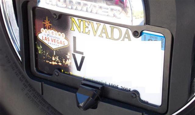

There are three. Good perspective when mounted here and yes, it's a great help when backing up. If you wire it correctly, you can manually turn it on while not in reverse, which is sometimes entertaining while sitting at stop lights.

Which camera is that? Is it wide angle? I am leaning toward the hitch location or bumper. This location does give me some new ideas. Although I have considered removing the spare tire all together.

The camera is Hitchcam's Framecam. Not sure if it's "wide angle" but it definitely sees beyond the outside edges of the truck. The cam mount can be swiveled up and down. Mine is set to show 12 inches behind the tire on the bottom edge of the view. The top edge of the view is higher that horizontal.
Worth noting, perhaps: If you put the cam in a hole drilled in the bumper, if you ever go to 37" tires and keep the spare on the rear, the larger tire may block the view.
