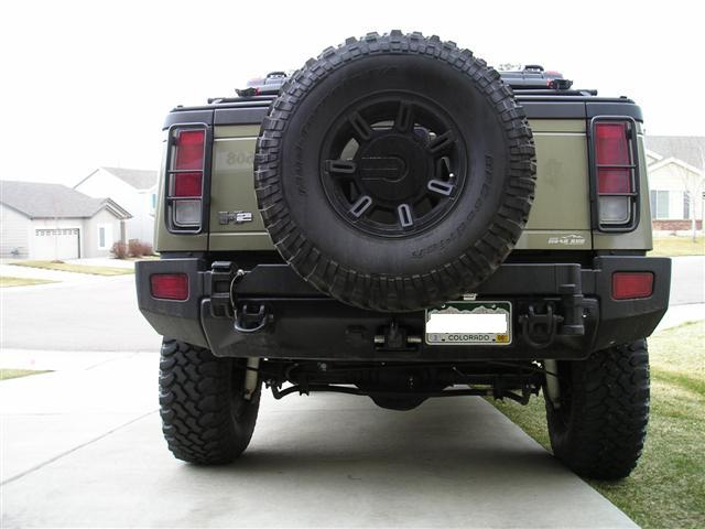

If you are keeping your tire where it is, you can always do what I did.
Buy a frame and bolt it through the rear bumper, go to AutoZone and buy a license plate light and mount it too the underside of your tire carrier. you will have to cut down the hub inside the tire to put a center cover over it. You can use the existing wire for the light too.
This took about 30 minutes.

was it a bitch to wire the light or did u not have to? remember iam a retard with tools and this stuff!! what about using that space on the tire swing just below the spare? i dont sit as high as you i think wonder if i couls squeeze it in next to the spare?
Old 12-09-2005, 10:27 PM
Adter many different locations and brackets, this is what I ended up with. The lighting is only two wires and you just have to cut some off and heat shrink the splice into your new license plate light. VERY EASY TO DO! The light was $6.00 and the plastic fram around the plate was around there too. After two trips to MOAB the plate stayed intact and untouched. You don't want to mount the plaste to the swing gate because part of the plate will be ubstructed and you ahve no way to mount the light than.
This took about 30 minutes. </div></BLOCKQUOTE>Do you have the part #'s for the frame and the light you used? I would like to do the same on my '03 becasue I don't like where the plate is mounted.
Also, are those the new BFGoodrich Mud Terrain you have on your SUT in the pic and are they loud on the street?

That looks like the easiest and cheapest way to do the light.

no those are not the krawlers if that is waht u are asking the are just plain old bfg mud terains!!!
