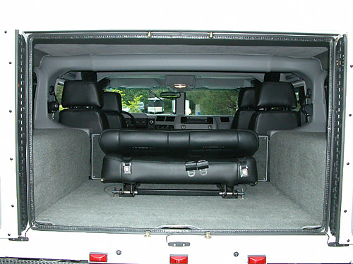

I went to a junk yard, got a third row seat for a 1989 Chevy Suburban. I took it and got it re-clothed to match the interior.
Then I drilled through the floor and put in exhaust clamps with the "U" of the clamp upside down. This way the seat grabs onto the clamps and is removable.
There winds up being a space between the middle seat and the rear facing seat perfect for a jump starter, flares, first aide kit, fire ext and a charging mag lite. It is all hidden between the seats.
The Suburban seat folds forward (toward the rear of the vehical) so you can put more stuff in the back if needed.
Remember the forward facing monitor so the kids can watch DVD's while sitting backwards!
Our kids love it and are always fighting for it.
Good luck!

I'll get some pics. The best part about this seat is that the seat belts are already installed on the 1989 Suburban Seat.
I have done this for my H2 and my Chevy Tahoe. I used 1/2" shank Exhaust bolts that are bigger and stronger then what was in the original Suburban. The seat is going no where. I just set the U-bolts into the floor after marking the carpet with chaulk. Had to play around a bit but the seat is held in firm and the back rests against the middle seat.
Easy to remove as you just pull up on the handle behind the seat and pull it out.
The only thing left on the floor is the U part of the exhaust Ubolts which still allows plenty of cargo.
Greg

Old 06-10-2005, 01:51 PM
passerby passerby is offline
Posts: 27
passerby is off the scale
I picked out a seat at the junk yard from a 1989 Chevy Suburban, 3rd row seat for $50. I had it re-clothed and stuffed for $150. Looks like new and very closely matches the wheat interior.
The seat is easily removed as it has 2 little horizontal C shaped brackets in the front that slide under the exhaust U bolts I installed and two clamps in the back that clamp around two additional exhaust clamps I installed.
When you pull the handle up on the back of the seat, the 2 back clamps open. Pull up and then about 2 inches back to get out of the C clamps in the front of the seat and you are done.
(Tried to draw a clear visual for you)
The seat lowers down as well by the pulling of another handle for more storage.
There is about 4 inches of space under the seat for jumper cables and a flat tool kit.
Behind the seat (between the middle seats and this rear facing seat) there is a triangle space that I store a jump starter, first aide kit, rope, mag lite, tarp, blanket.....hmmmm, I think that is it...oh, and a compressor. It is a nice hiding place.
The seat has it's own seat belts and 2 arm rests.
The only thing on the floor when you remove the seat are 4 super hardened u bolts (upside down) that stick up about an inch. As this is the bottom of the U, they are smooth and rounded so I slide cargo right over them.
I actual threads and nuts point down through the floor.
I hope that gives a good idea. I did this for my Tahoe as well. I can now interchange them.
Hope that helps.
Greg

GeorgeSSSS, it takes less than 60sec to remove the seat. There are two large "wing-nuts" you unscrew and just lift it out. The mounting brackets are the only things left inside. They are prolly 1" high x 1" wide x 18" long
...mounted to the floor on left/right sides next to inside wheel-well covers. Not in way of any cargo. The kids all fight over the new "bus-seat". Our 3yr old wants to just be left to play inside and always says.."can i play in yer Humma' Dad?". They all have fun back there now. They climb in/out thru the lift-gate.

George, the holes are already there. (spare tire support holes and 3rd row seat holes) You need to fold or cut the carpet back just enough to mount the new-seat brackets. Very easy install.
