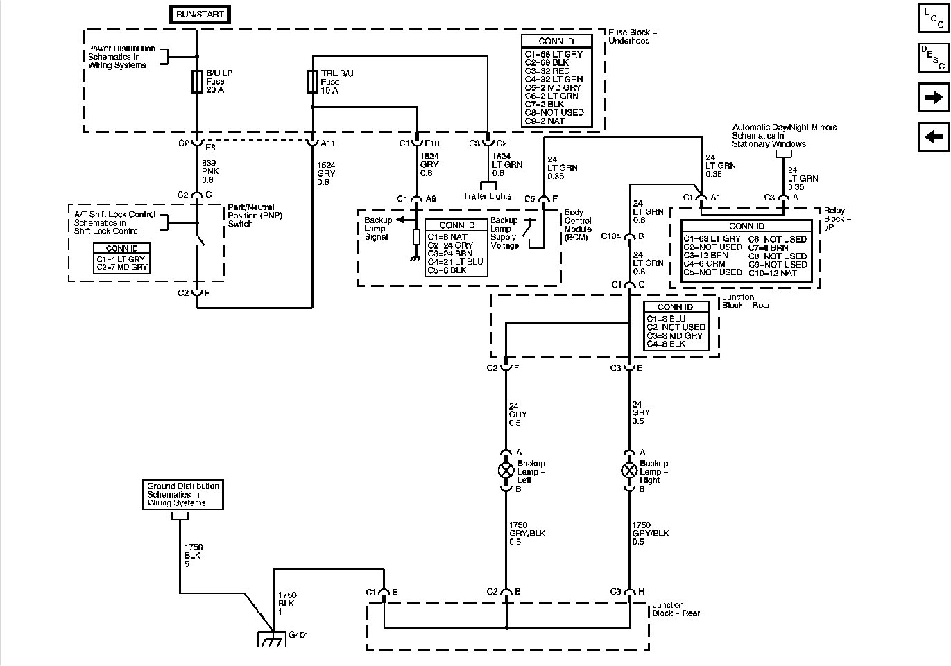

Old 09-30-2004, 12:51 AM
Klaus's Avatar
Klaus Klaus is offline
Location: CSA
Posts: 2,511
Here's a wiring schematic and a description of the backup lamps circuit.
<BLOCKQUOTE class="ip-ubbcode-quote"><font size="-1">quote:</font><HR>Backup Lamps
The backup lamp request signal is sent from the powertrain control module (PCM) to the body control module (BCM) on the Class 2 message system. This signal is based on the park neutral position (PNP) switch signal. The BCM supplies voltage on the backup lamp supply voltage circuit to the backup lamps and to the automatic day/night mirror. Voltage for the courtesy lamp supply voltage circuit and backup lamp supply voltage circuit is from the TBC B fuse in the instrument panel fuse block directly through the BCM to these circuits. A short to ground on either of these circuits will open the fuse. The backup lamps are grounded at G401.
For trailer wiring, a separate backup lamp circuit is connected through the underhood fuse block from the TRLR B/U 10 A fuse to the trailer wiring harness.
<HR></BLOCKQUOTE>

Old 10-01-2004, 01:20 PM
Klaus's Avatar
Location: CSA
Posts: 2,511
I haven't done a backup camera install, so I have no prior knowledge. I'll try to find out more info tonight for you.
According to the schematic, there are two LT GRN wires (one larger than the other) that connect to the I/P Relay Block. Connecting a relay to either wire should work.
I'd suggest you use a voltmeter to be sure you have the correct circuit.
The other option would be to tap into the TRL B/U Fuse (10A) circuit in the Underhood Fuse Block.

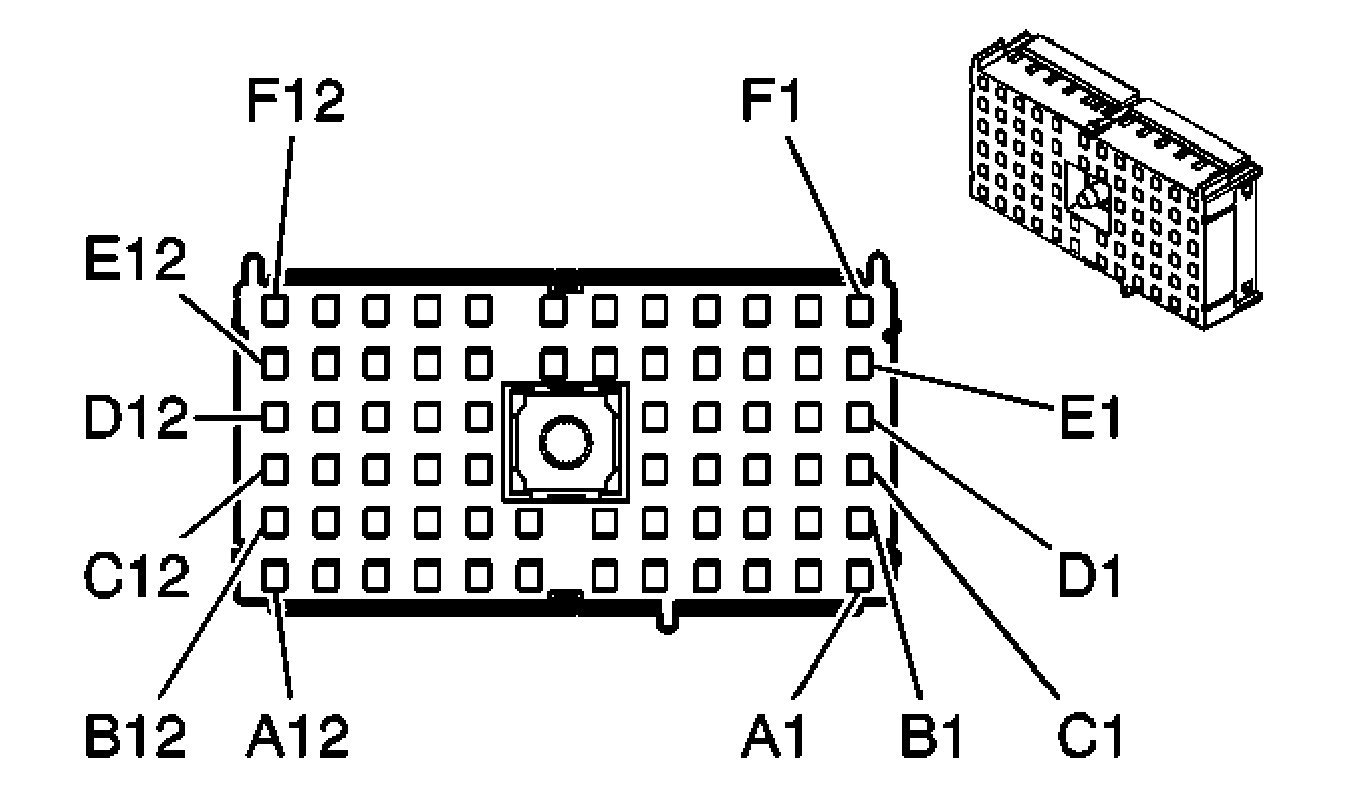

Old 10-02-2004, 12:29 PM
Klaus's Avatar
Location: CSA
Posts: 2,511

<p class=MsoNormal>Connect your backup camera relay to the larger of the two
L-GN wires in cavity A1 of the Relay Block – I/P.</p>
