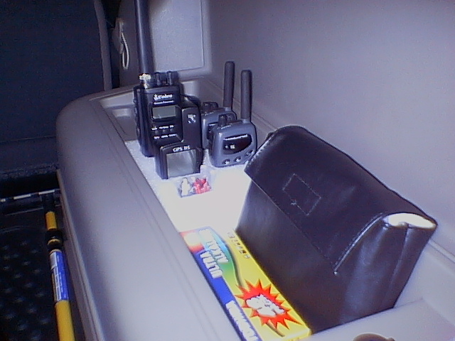

Given the low cost of the FRS radios and CB radios it would be foolish not to buy both. I opted for the hand held CB. Here is a picture of the setup I have in the back of my H2. I actually just picked up another set of rechargeable FRS radios with a desktop charger on sale at LL bean.
