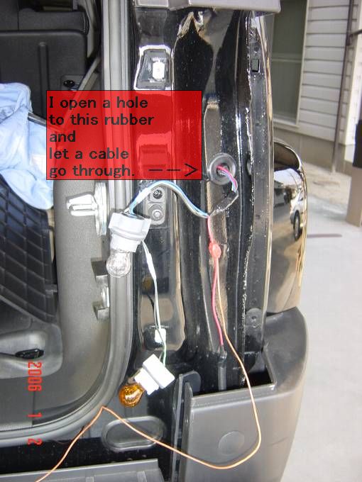

I had it in this way.
1. I take off a rear lamp (the right).
2. I open a hole to this rubber.
3. I let a cable go through.
4. I drill it with a drill in a storing box of ??the middle.
???Two places of the hole where a cable is ???in and an appearing hole?
5. ??I let you penetrate the hole which ?????opened out with 4. and put a cable through ??rear right seat bottom.
It is the fifth that it is difficult in this.
