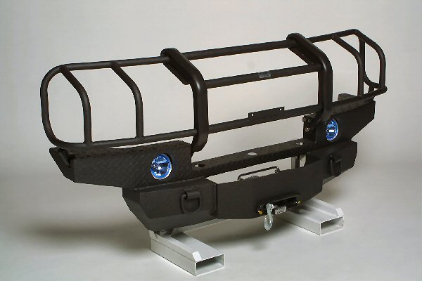

I like the bumber reminds me of the ARB bumper I put on my sub.. What brand is the Brushgaurd/bumper? Do you have an actual weight.
Mike

<BLOCKQUOTE class="ip-ubbcode-quote"><font size="-1">quote:</font><HR>Originally posted by Centerfire:
Mike
<HR></BLOCKQUOTE>The bumper is from the fine people of Tough Country Products. I don't know the actual weight, but I know that it takes some serious man power to handle that thing. It took 3 people to get the thing off to install my winch.
I've bashed it over many rocks and the bumper is unstoppable!
They have a sweet rack that I'm having installed Thanksgiving weekend as well. I'll post lots of pictures when I get back from El Campo.
