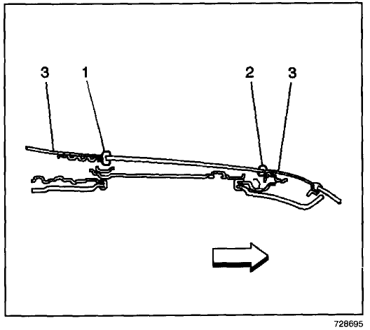

There are also mechanical adjustments to the sunroof. Here's the procedure. If you suspect this is the problem you may want the dealer to do this under warranty.
1. In order to adjust the glass height, the sunroof glass must be in the zero, closed, position. IMPORTANT: Do not remove the screws from the sunroof mechanism.
2. Loosen the 4 adjustment screws NOTE: Refer to Fastener Notice in Service Precautions.
3. Adjust the rear glass panel (1) so that it is flush with the roof panel (3), 0-2.0 mm (0.079 in) above 3. Tighten Tighten all 4 adjustment screws to 7 N.m (62 lb in) .
4. Adjust the front glass panel (2) so that it is flush with the roof panel (3), 0-2.0 mm (0.079 in) below 3. Tighten Tighten all 4 adjustment screws to 7 N.m (62 lb in) .
