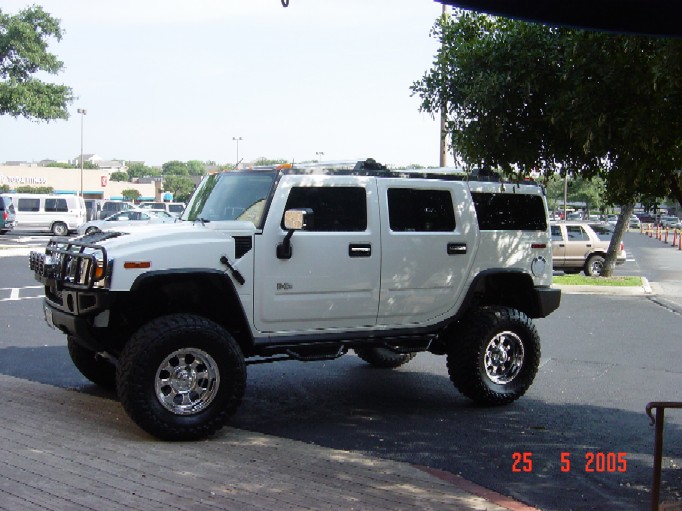

Old 10-31-2005, 12:46 PM
JamesT's Avatar
JamesT JamesT is offline
Join Date: Aug 2003
Location: San Antonio
Posts: 1,635
Hey, mine has never rubbed! I run 38's.
Here's some info on my Fabtech install;
http://www.*******club.com/tech/lift.html
38's rub hard when wheeling with a 6" lift, so expect 39's to rub hard also. However, they mainly rub on the rear of the front wheel well and just require about the bottom 6" of wheel well liner to be trimmed out. They will still rub against the sheet metal behind it, but only just. So it isn't a big deal. </div></BLOCKQUOTE>
