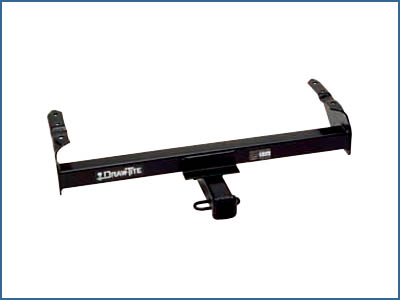

Attached is the Draw-tite hitch and the link to the installation manual:
http://www.draw-tite.net/pdf/N75382.pdf
