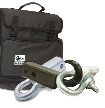

4wheel parts has an attachement hook or shackle that plugs into your hitch on the back. That's what we use. The cost is only like $10.00 for the recovery hook or you can buy a whole kit. Make sure you know how to use this stuff safely before you just try to pull someone out. here's a pic of what i have.

4wheel parts has an attachement hook or shackle that plugs into your hitch on the back. That's what we use. The cost is only like $10.00 for the recovery hook or you can buy a whole kit. Make sure you know how to use this stuff safely before you just try to pull someone out. here's a pic of what i have. </div></BLOCKQUOTE>
If you don't have the adapter you can also just put the loop of the recovery strap into the hitch receiver and put a hitch pin through the loop to hold it.
