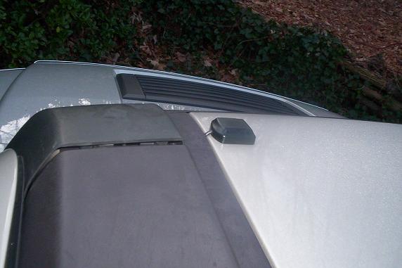

fourfourto's Avatar
This is were they put my gps antenna
Old 02-09-2006, 02:28 PM
<BLOCKQUOTE class="ip-ubbcode-quote"><div class="ip-ubbcode-quote-title">quote:</div><div class="ip-ubbcode-quote-content">Originally posted by fourfourto:
This is were they put my gps antenna </div></BLOCKQUOTE>
That looks good. I will have to move it back just slightly because the marker lights being install but make go there.
