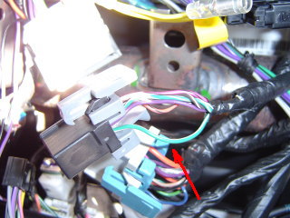

ok, i figured i'd show some pics to verify this pcm and/or bcm plugs.
which plug is the pcm and which is the bcm. Im still having difficulties finding the speed sensor and brake sensor.

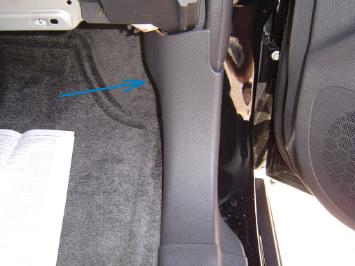

BCM (Body Control Module) is located in the PASSENGER KICK PANEL.
Old 01-07-2006, 11:20 AM
BB BB is offline
Location: JAPAN
Posts: 142
BB is an unknown quantity at this point
As for speed signal, it's dk grn w/ white of smaller audio connector.
Old 01-07-2006, 12:22 PM
f5fstop's Avatar
f5fstop f5fstop is offline
Location: Idaho
Posts: 4,744
BB is correct, but may I add a caution.
The black connector to the radio, contains two dark green/white wires, so make sure to look carefully at the photo supplied by BB and connect to the correct wire on terminal E. The other wire is the class 2 serial buss wire.
The photo you displayed, is of the underhood junction (fuse) block and the connectors circled are primarily ignition supply voltages, ground or crank voltage.

<BLOCKQUOTE class="ip-ubbcode-quote"><div class="ip-ubbcode-quote-title">quote:</div><div class="ip-ubbcode-quote-content">Originally posted by BB:
As for speed signal, it's dk grn w/ white of smaller audio connector. </div></BLOCKQUOTE>
Got the passenger kick panel thank you! I'll route that way and let you know.
as for the speed signal. My black radio plug only has two wires from it... pink and orange w/black stripe.
My radio is the basic non bose does that make any difference?

BB BB is offline
Location: JAPAN
Posts: 142
Mark M, my H3 has Monsoon Sound System, so there may be a difference in wiring between Basic and Monsoon ???

<BLOCKQUOTE class="ip-ubbcode-quote"><div class="ip-ubbcode-quote-title">quote:</div><div class="ip-ubbcode-quote-content">Originally posted by kodiakz:
Glad to hear you got it working! Where did you end up tapping into a vss wire? </div></BLOCKQUOTE>
Ok, so for the non monsoon radios the black plug that everyone suggested to tap into with the green wire turns out to be for the base radios is the same plug however its the pink wire w/ black stripe. Its on the same location as the green wire if I had the monsoon radio.
