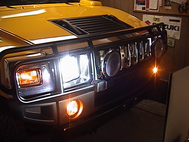

I'll try a see if this pic loads.
DRL's and HID headlights on together. The DRL's appear to create a lot of glare at night. The beam is almost like a flashlight on wide beam, only a lot brighter.
