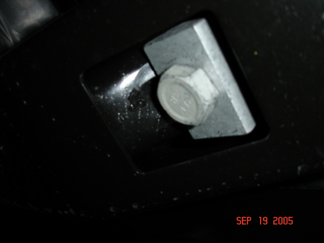

I crawled under the H3 today to adjust the torsion bars but found that it looks completely different than my H2's. On the H2 it stuck out about an inch. This is right up against a steel plate.
For those of you who have, does this look right and if so, is it clockwise to lift the front?

What the H2's look like. Also, on a Chevy forum I remember reading that the tire should be off the floor before cranking the torsion bar to lift the front end. Is that true?
when I asjusted teh torsion bars on my H2 it was to lower the front end so this process is new to me.

Yes, thats the bolt. As to which way you turn it, I turned it the way I read on one of these posts and it lowered it. I ended up having to do it again. Also I only did it a total of 2 turns and the truck rides the same but appears more level. Definetly you have to raise the front tires off the ground 1st.

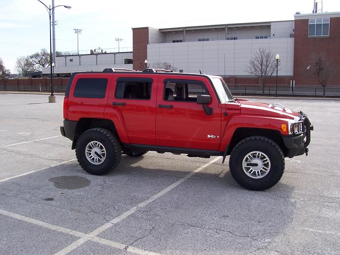

I made 2 clockwise turns on torsion bar bolt and it raised the front about an 1". I was hoping for some additional height but I'll take what I can get. I drove it for a while and didn't feel any differences. Below is the photo after the adjustment.

Is there any functional purpose in doing this? Or is it just for the look?
Old 01-11-2006, 02:14 AM
MarK M's Avatar
MarK M MarK M is offline
Location: CA
Posts: 585
still looks racked... what about those leveling kits?

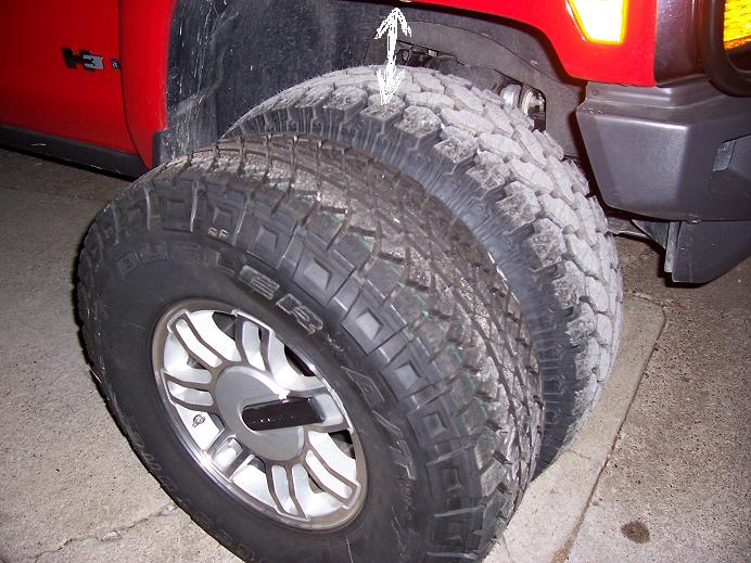

I measured from the top of the tire to the top inside fender. I went 2-1/2 turns and it moved it up alittle over a inch. You want to measure before and after..

This is where I measured from-- top of tire to inside fender well ,, I didnt measure from the ground. 6 inches approx,,before---7-1/4 after the way I remember with the old 33 Duelers on.
