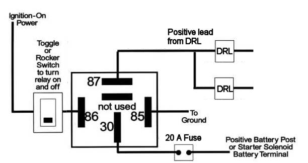

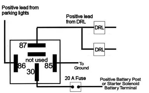

Below are two schematics to wire your DRLs:
The first one uses your parking lights to activate the DRLs.
The second one uses a switch that you install inside the vehicle.
First, some relay basics:
There are two basic circuits in a relay. One circuit turns the relay on and off; the other circuit passes current through the relay once it's turned on. The wire going to terminal 86 is the wire that activates the relay. When terminal 86 has power applied to it, the power goes through the relay to terminal 85 to ground. This turns the relay on. This allows high current (power)to go from terminal 30 to terminal 87, which puts power to the DRLs.
Basically, all you have to do is splice into one of the existing parking light's positive lead to the 86 post on the relay. Next splice both positive leads from the DRLs and combine into one wire of similar thickness. Take this combined wire and plug it into the 87 post on the relay. The rest should be self explainatory.

See image below

See image below

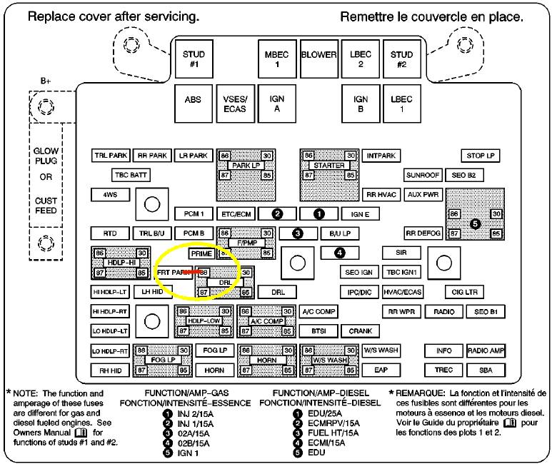

I'm studdying the fuse box in the engine bay. Apparently, there already exists relays for the DRLs.
I don't have my H2 with me (in the dealer having DVD system put in), but in theory, all you have to do is get a heavy guage wire and jump it from the FRT PARK fuse to #86 of the DRL relay. I'll have to try it when get the H2 back. If this works, it's like a freebie.
Anyone care to try in the mean time?
See pic below...Circled in yellow. Jumper is highlighted in red.

The parking lights have their own relays too (labeled 'PARK LP' located two relays above the DRL relay). So even though there's power to the parking light fuse, the relay is off so the parking lights will be off.

I haven't done the relay kit approach as I'm still trying to get the fuse solution working.
Your relay kit connection is partially correct. I'm not sure if the + wires are black (normally this is reserved for ground). If you have a voltmeter, you can find out rather quickly.
#85 should be to ground. #30 should be to + power. Just review the pics at the begining of the post.
As far as the fuses, I tried it and the parking fuse to the DRL relay did not work. Either the schematics are wrong for the relay points or there's a constant 12 V through the parking light fuse. One other thing I'm going to try is to trigger it on the parking light relay itself. I got lazy and did not put a voltmeter to it to see where the switched power would be to power the DRL relays.
When I get back after New Years, I'll spend some time to trouble shoot the connections. I'm going to get this working yet. BTW, the relays are a b*tch to take off. You have to pry it off with a chip extractor or a thin blade screwdriver. Man they are in there good.
