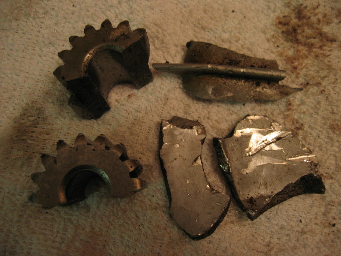

My H2's transfer case just broke for the third time this year.
I stepped on the gas to try and get quickly across a busy road and the piece of **** transfer case exploded and left me sitting half way out in the road. Oil and chunks of metal and plastic spilled out on the road. I am discussed with this vehicle. Two of the three times the TC broke I was just driving on the road.
Anyone else have transfercase problems?

My case just broke. The change forks and the change ring broke. These are made of plastic. I use my t-case alll the time. It will be in the shop for 9 days.

Old 11-29-2003, 02:37 PM
H2 Daddy H2 Daddy is offline
Location: Woodbury, MN
Posts: 385
H2 Daddy is off the scale
Here is a picture of the carnage.

Old 11-29-2003, 04:47 PM
buddy buddy is offline
Location: Florida
Posts: 216
buddy is off the scale
That sure looks like some pretty piss poor castings. Is it the picture or are those pieces as porous as they look? I know the cast TC housings are usually porous, but the gears too? Did the dealer replace the entire TC or just replace the previous broken parts and salvage the rest.
Hope GM's got a fix..and soon. It's just one of those 1st year bugs that will require a bigger dose engineering to get it well. Maybe Dr. Goodwrench got a cure on the way.Let's hope..

Old 11-29-2003, 06:59 PM
Posts: 385
No Supercharger
They just replaced parts on the last two repairs. Guess they will have to put in a new transfer case now.
I do off-road but drive most of the time (98%) on the street.
The picture is accurate, the parts are as porous as they look.
I can change any of the parts back because it was towed into the dealer.
I also thought the dealer had to prove the modification caused the damage.

Ok, I have calmed down and want my H2 back from the dealer. They did not say a word about the modifications. They shouldn't any way. The mods are very mild and have nothing to do with the TC problem. My dealer has a great service manager. He said he was going to fight for a new TC. I said they would need a new TC. He said no, they could get a new case use the parts that are still good. After he got an answer from GM he is going to overnight a new TC case and get me on the road in a few days. They gave me a Cadillac to drive.

It is official. I got my H2 back today with a new transfer case. No questions were raised about the intake and exhaust mods.
