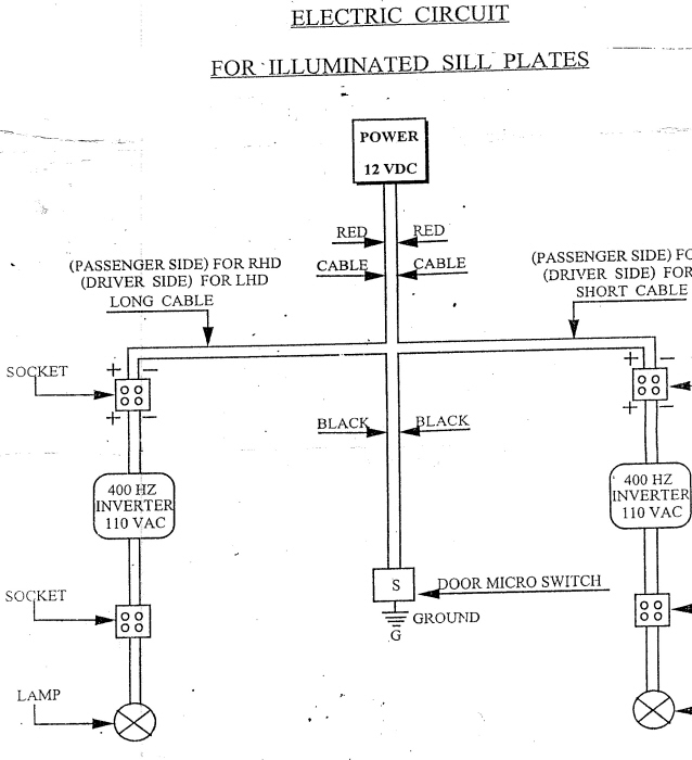

I just purchased the lighted door sills and of course they came with only a wiring diagram (which I dont understand). Any one know/have instructions on installing these things?

Taz will likely answer but if he doesn't and you want to scan and post the schematic, I'm sure any one of a number of people can help.

I am going to post the wiring schematic and see what you guys can figure out. One thing that would help me is if I could know where the door micro switch is. If I knew that I could find the wires I need to tap into, but I can't find the micro switch.

Skylo I absolutely shocked that the dealer cannot pull up on there computer the schematic or part list and find the micros. That is how We did was the dealer service manager went to computer looked it up and said here and here etc. I'm going to call My service guy now.
Skylo here is what He and I seem to remember, We did not use micro switch but wired to the floor lights power on the b pillars on each side fo the rig beside the front sets. We are fairly sure but, not 100% since it has been a good while. All your doing is wanting them to come on and off when door is opened so wiring to those B pillar light should take care of that.
I would ask service at your dealer but, that is the direction I would lean unless You can come up with something more concrete.

I am working on it now, but looking at the schematic....Does anyone know which wires go to which of the two wires on the light (I opened up the light and there are 2 wires ..BLK w/white stripe and all BLK).
