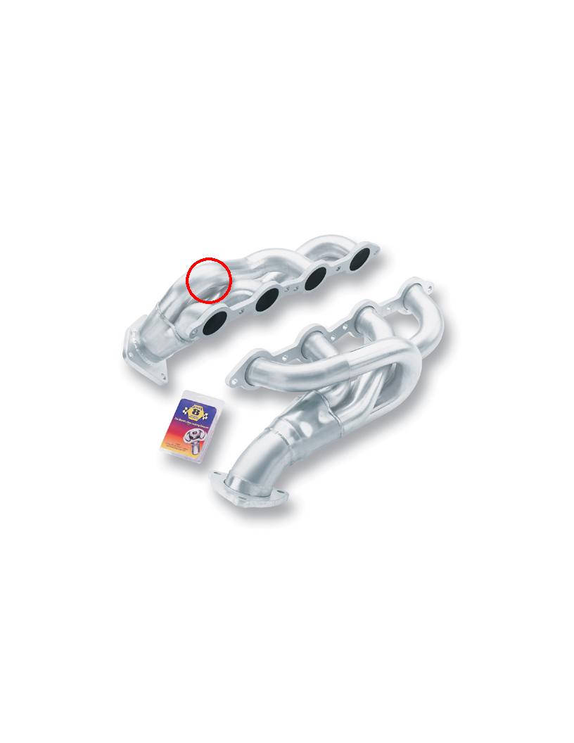

Yeap, unfortunately, that's what I meant:
<BLOCKQUOTE class="ip-ubbcode-quote"><div class="ip-ubbcode-quote-title">quote:</div><div class="ip-ubbcode-quote-content"> </div></BLOCKQUOTE>
It's one thing when a company makes a product with problems, as long as they fix it, I think it's all good. But what really ticks me off with Borla is they don't even bother to call you back after leaving them 6 messages in 2 weeks.
Attached is a pic of the product, the problem i had with their headers is the tube area circled in red. This tube is in the way so when the plug wire comes out, they contact. I am sure this problem can be fixed with a bracket or a different angled plug wire boot. But I was simply upset at Borla because they weren't taking care of their customer. Just for that reason I would never buy anything from Borla again, that's all.
And I do regret ordering the exhuast system from them at the same time for the same reason but it was already installed. Beside, the rattling problem maybe more of an installation issue. Whereas the header melting the plug wire and running on 7 cylinders is a much bigger issue.

Borla headers are no problem for me! Worked great and installed them myself...
Quality plug wires such as magnecor and a twist of the boot to angle the wire and no problem with wires melting...

After the first factory wire got fried, I also replaced all eight with the red Magnecor (#85241), which are supposed to be more heat resistance. I also twisted the coil end so it wasn't leaning on the header but it was still very close and it only took 20-30 miles of driving before the magnecor got fried too. Then I had to buy another set of magnecor because I don't want non-matching plug wires on a fairly new truck, just didn't seem right to me Plus I bought some header wrap, steel zip ties, and these foil sleeves made especially for plug cable boots and it lasted 50-60 miles. In my point of view, I had to spend another $200+ trying to fix the problem because Borla sold me a poorly designed product
So glad to hear not everyone had to go thru what I had. Maybe the header I got was just a bad one (mis-welded?). But that still doesn't gives Borla any excuse of not returning calls to their customer. What a shame!
