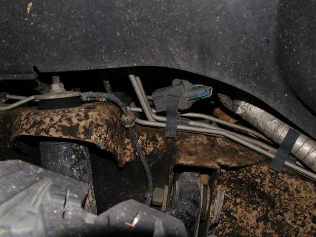

Found it not attached to anything and just hanging there. Can someone look to see where theirs is attached or if it is attached to anything.
Pic 1 is the relay.
Pic 2 is the manual showing the relay.
Pic 3 is where it was found.
Pic 4 is where I attached it.
Thanks,

Old 08-15-2004, 03:10 PM
This where mine is

Paragon, I thought about that but thought it would be a square peg in a round hole Yours was from the factory that way ?
Thanks again, Ed
Old 08-16-2004, 12:11 AM
Square peg in a round hole is exactly right. I assume it came that way, I haven't touched it. I've had mine for 2 years and it's been at the dealer a time or two for a problem with the air suspension and they might have done it. But I have never noticed it before so I assume it has been that way from the getgo.

JUST LIKE TO SAY THANKYOU I HAVE GOT 03 H2 WITH AIR SUSPENSION ON DIC I REMOVED THE RELAY CLEANED THE CONECTIONS RE FITTED IT AIR SUSPENSION NOW WORKS FINE I HAVE NO WARRENTY ON H2 IN THE UNITED KINGDOM THANKS DAZ

It actually attaches on the inside of the fender well, just above where it is lying on the frame. Open your hood and jump up on the tire and look down and you can probably see where it goes. Many of them do end up just hanging down, but they are suppossed to attach on inside of wheel well.
