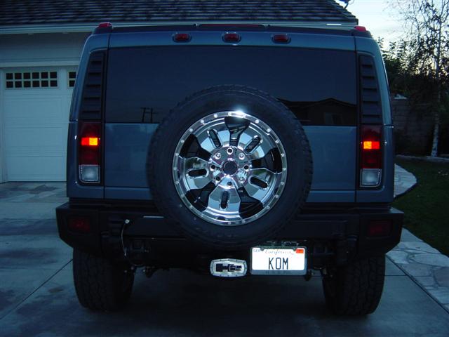

I finally finished getting my spare Lexani mounted to the rear. Also had to relocate the plate. Here is a before and a few after pics.
Before

Old 01-05-2006, 11:54 PM
kom's Avatar
kom kom is offline
Location: Claremont, CA
Posts: 56
kom is an unknown quantity at this point
After

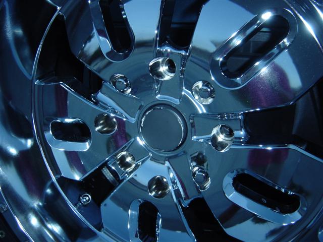

Old 01-05-2006, 11:55 PM
kom's Avatar
kom kom is offline
Posts: 56
After #2
