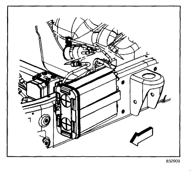

i tried searching and couldnt find anything.i took a quick look along the drivers side frame rail and didnt see it,can someone tell me where it is?

It's mounted to the outside of the drivers side frame between the fuel tank and engine.
Jonahs
Old 06-29-2005, 05:29 PM
Fram G9344. Having one to look at may help you find it.

Come again, again? For '03
<BLOCKQUOTE class="ip-ubbcode-quote"><div class="ip-ubbcode-quote-title">quote:</div><div class="ip-ubbcode-quote-content">Description and Operation
FUEL STRAINER
The fuel strainer attaches to the lower end of the fuel sender. The fuel strainer is made of woven plastic. The functions of the fuel strainer are to filter contaminants and to wick fuel. Fuel stoppage at this point indicates that the fuel tank contains an abnormal amount of sediment.
IN-LINE FUEL FILTER
The fuel filter is located in the fuel feed pipe, between the fuel pump and the fuel injectors. The paper filter element (2) traps particles that may damage the fuel injection system. The filter housing (1) is made to withstand maximum fuel system pressure, exposure to fuel additives, and changes in temperature. </div></BLOCKQUOTE>

Come again, again, again? For '03
FUEL FILTER REPLACEMENT
REMOVAL PROCEDURE
IMPORTANT: Inspect the fuel tank internally and clean the fuel tank if you find a restricted fuel filter.
1. Relieve the fuel system pressure.
2. Raise the vehicle.
3. Clean all the fuel filter connections and the surrounding areas before disconnecting the fuel pipes in order to avoid possible contamination of the fuel system.
4. Disconnect the threaded quick connect fittings from the fuel filter.
5. Remove the fuel filter bracket bolt.
6. Cap the fuel pipes in order to prevent possible fuel system contamination.
7. Slide the fuel filter from the bracket.
8. Inspect the fuel pipe O-rings for cuts, nicks, swelling, or distortion. Replace the O-rings if necessary.
INSTALLATION PROCEDURE
1. Slide the fuel filter into the bracket.
2. Remove the caps from the fuel pipes. NOTE: Refer to Fastener Notice in Service Precautions.
3. Connect the quick connect fittings (1, 2) to the fuel filter.
4. Lower the vehicle.
5. Tighten the fuel filler cap.
6. Connect the negative battery cable.
7. Use the following procedure in order to inspect for leaks:
7.1. Turn ON the ignition, with the engine OFF, for 2 seconds .
7.2. Turn OFF the ignition for 10 seconds .
7.3. Turn ON the ignition, with the engine OFF.
7.4. Inspect for fuel leaks.
8. Install the engine sight shield.
Jonahs
