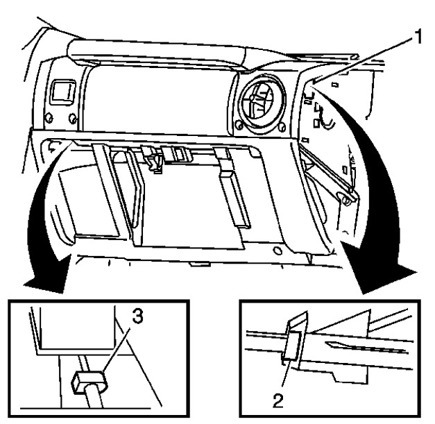

i figured out most of it .. it seems that the handle in front of the passanger seat is holding on the cover and i cant seem to figure out how that comes off...???

Instrument Panel (I/P) Assist Handle Replacement
Removal Procedure
  1. Remove the passenger I/P (Instrument Panel) side trim panel. Fully open the I/P storage compartment.
    Important
    Both the left and the right assist handle release buttons face the outside of the vehicle. The release buttons need to be pushed towards the inside of the vehicle to release the assist handle.
    Using a long flat-bladed tool, through the opening in the I/P retainer (1) on the passenger side of the I/P:
    1. Push in on the assist handle release button (2) and
    2. Pull out on the handle to partially disengage the assist handle.
    Using a flat-bladed tool, through the I/P storage compartment opening, push in on the inboard assist handle release button (3).
  2. Remove the I/P assist handle.
