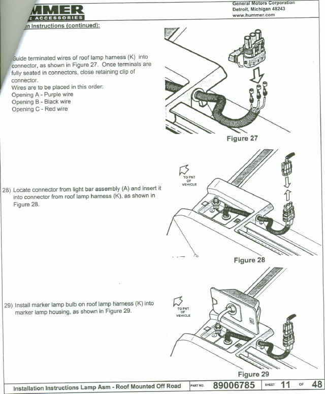

Old 12-27-2003, 09:52 PM
Spike Spike is offline
Location: Whereabouts unknown
Posts: 2,267
Centerfire,
I just wired up a roof rack light bar. I ran the wire harness out under the base of the driverside roof light. If you look you will see a cut-out on the rear of the base of the driver side roof light. You don't need to drill a hole in the lense or run the wire under the lense. Take the lense off and run your wire through the access hole inside the light base and then route your wire towards the rear of the base through the cut-out. You will need to silicone the opening you make through the gasket seal over the access hole after you run your wires. I was lucky the wire harness that comes with the roof light bar comes with a new access hole gromett/gasket built right into it to replace the one that it already in there.

Old 12-27-2003, 10:45 PM
Posts: 2,267
Here is a copy of the roof rack light bar installation instructions diagraming the roof light base and the rear cut-out in the base. Pay particular attention to figure 29. The large thick black wire is the route I recommend you take to run your wires.
Old 12-27-2003, 10:48 PM
Posts: 2,267
I think only the 2 outer roof lights are set up like this. The 3 lights in the middle do not appear to have bases that you can run wires from.
