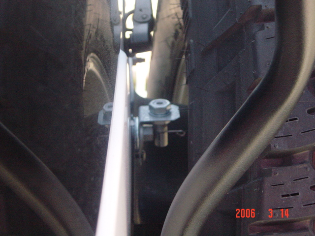

I popped this question over in the photos thread as well, I couldn't view the photos for some reason, but that thread was almost a year old. Anyway I remember the photo very well it was just before \ after the H3 came out and it was a yellow one at Silver Lake, this State Park require a really tall orange flag on the front of all vehicle so they can spot you cresting hills. Anyway I am trying to find out the best way to get the flag attached to the vehicle. I have the flag and it is a bottom mount (essentially it has a threaded bottom) didn't know if the owner \ tester of the that yellow H3 could give me some hints or if anyone else had some pointers.

Neocon has a mount on his, he put some info in a thread a while back. Just use a cb mount or an L-bracket and mount it to one of the tow hooks or brushguard.

Here is a quick release I got from a motorcycle shop. I just mounted it to a bracket behind the spare. The mount always stays on and the flag slides in and out.

lvr has a real nice set up with mine the swing gate cant be opened
