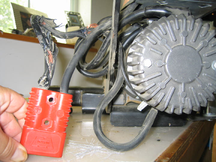

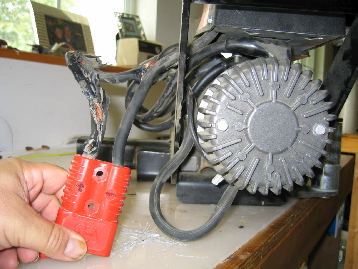

As many of you may have heard...I had an close encounter of the flamable kind. Not smoke, FIRE!
So there I was driving along when suddenly the GPS makes some noise about loosing external power...not more then a second follows and my dash is lit-up like a 747 blinking away. A second passes and (as I pull off the road) the whole rig shuts down: the smell of electrical burning is detected. Um...yeah: falls into the category of NOT GOOD!
Up front smoke is rising. We run to the front and find the winch wires molten & smoking. As we pull the quick-disconnect apart a passing motorist pulls over and comes running with a fire extinguisher. His words: you've got a FIRE
going on!!!!
Sure enough...just under the wheel well is live flame. A wire had become so hot that the insulation caught fire and was working its way up into the engine compartment.
We got the fire out likety-split and very minimal damage occured. Today I solved the problem:
The guy I bought the winch from had not had a professional do the job, he had done it himself. He wired the winch polarity backwards and positive juice was flowing right into the ground/carriage of the winch. The paint on both the carriage and H2 recepticle had kept things insulated well, but finally it contacted and the "electrons hit the fan".
You just know I've got pics for ya'all:

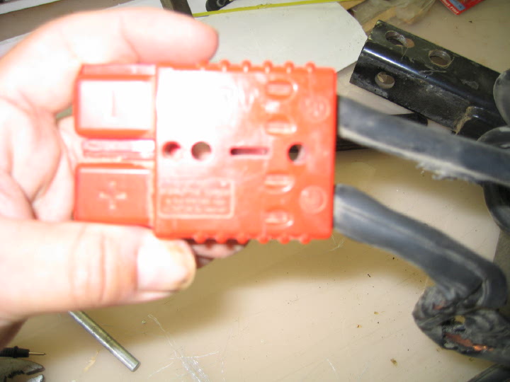

more

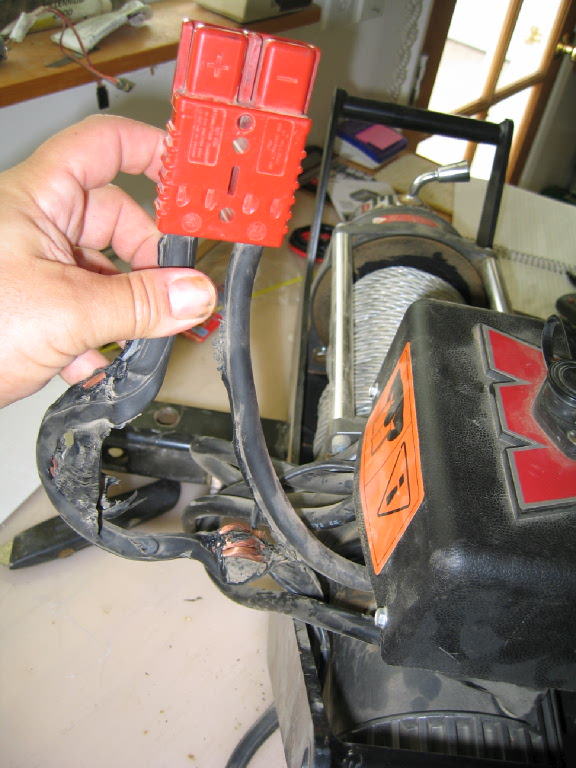

more 2

and yet more

So there ya go...
Clearly you can see that the negative wire is headed straight into the solenoid box AND the positive wire is (melted, scorched, elonngated)...but attaches to the ground of the winch motor.
Not GM's fault, Not Warn's fault.....just the guy who sold it to me. I won't say who he is....but he's a good guy and obviously just made a mistake.
All things considered, I got off easy. I need only to replace the one wire that melted on the winch and one wire that ran from the battery to the ground on the front bumper.
Hey guys...carry a fire extinguisher. If not for you, then perhaps for the other guy you see smokin' away on the road!
Now, let's never speak of this again!!!!

Allow me to cast some illumination on the winch subject. Yes...I did purchase it used. I was under the impression that the winch came complete and was an item purchased from a shop.
The reality of the situation is that the winch motor and solenoid controller were bought from Warn, a company made a carriage to hold the winch...and the owner himself apparently wired the thing up.
I never suspected the former owner wired it himself.....it looked as though it came out of a large crate and came wired from the Warn factory. It seemed stock and OEM.
Ironically he kept the winch strapped in his truck and only used it occassionally. During his occassional use he never rubbed enough paint off the carriage or H2's receptical to conduct the short-circuit.
Even though the polarity was switched, he apparently never noticed that the direction of pull/let-out was reversed on the hand-remote. So it worked for him and he expressed that it worked fine.
So there ya go, being that it worked fine for him AND that it looked completely Warn-factory original wiring....it 'ELUDED' me.
Now here's the dumb part. Being that I had no idea that the former owner wired the thing...I called him and left a messgae telling him about how I need to go after the dumbF**k who wired it wrong. He was less then amused by the profantic reference and just denied that it could be that case.
I explained that I wired my entire house, every outlet, switch, recessed light, alarm system, etc, etc and that I've designed electrical circuits. So he replies: "that's A/C current....D/C is different. Okay
I told him I had pics that show that he wired the + wire directly to the winches motor. He challenged me to send him the pics. No apologies, no regret, no regard for nearly torching my H2 to the ground. That's just him. He's still a good guy.
In the end, I cut-back the molten part and the connector wires fit easier now. The one wire the melted & burned did little damage because we hit it with an extinguisher real quick. I've replaced that wire and everything is basically fine.
Bottom line: I got off way lucky. Electrical fires are usually devastating!
