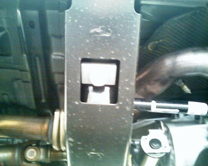

just making sure these are the correct ones before I do anything lol, pic taken from underneath just alittle behind the drivers side door.
Jack it up, mark them, both L/R side 2 full turns clockwise (while looking up at them from the underside), drop it and enjoy..... sound right?

That's the one!!!
Don't forget to mark it, and count your turns carefully.

might be kinda hard to turn. I'd either jack up the front end or get a cheater pipe for leverage.

The front end should be jacked up from the center so both front wheels are off the ground.
Get an alignment afterwards.

you have to jack up the front , get the front wheels off the ground and crank away
