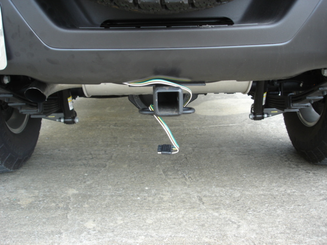

I hooked up the lights too! All the wires you need are taped to the main bundle near where the tag light pig tail comes off.
I post some pics and other info here:
http://elcova.com/groupee/forums/a/t...5/m/1921063831

thanks Av1ator, do u have a pic how it looks from the rear...

HEEERE Ya go!
Old 10-05-2005, 08:49 PM
fourfourto's Avatar
looks like you dont need a stepdown factory one is higher might nead stepdown

The install turned out clean!

Thanks, much better with the factory hitch. too bad it's not done right on all of them! but the install looks nice on the aftermarket! There are skid plates for hitches so at least it'll slide a little

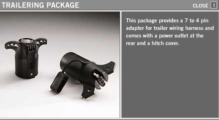

A lot of dealers order all their H3s for stock with the hitch because of how it integrates with the bumper. If you order it with the hitch, tell them you don't want the trailing accessory kit or whatever it's called. They charge $150 for it but I have seen everything that comes with it at Wal-Mart for about $25 total.

So what is "included" in the accessory kit?
Old 04-04-2006, 08:24 PM
Per Hummer.com

That's it??? I don't think so, put the $ tword under body or brush gaurd. Thanks for the info!
