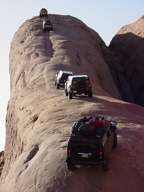

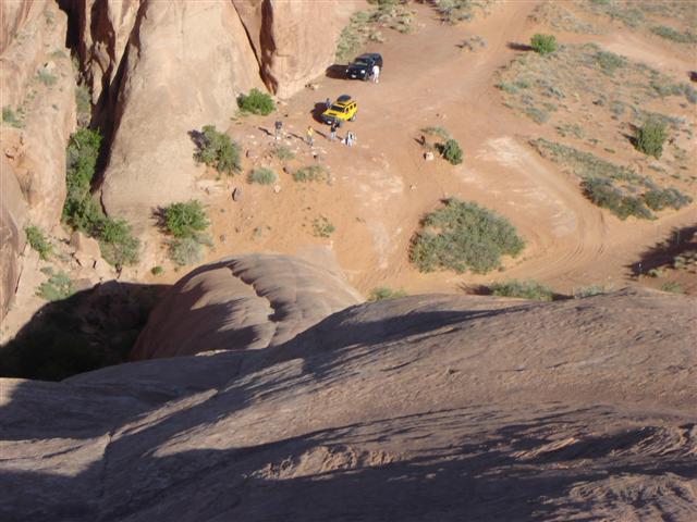

beebster and i are the only h3's and the 2's we were with are Moab veterans . the truck will do alot more than advertised but dont feel inviencabel we both had front diff failures on our last day but we broke them on an obstacle that busts tons of rigs H1 had busted a axle the day before and it can eat up h2 tie-rods . if your on bigass slick rock just crawl if you try hittin stuff hard and spinnin wheels things can bust
Heres the view down , beebster and i are the first private owners to take our threes up lions back and thats our story !!!!!!!!!!!!!!!!!!!!!!!!! and we are stickin to it !!!!!!!!!!!!!!
You Guys Got Some Concrete Freaken .."GoNads....!!!!
Well Done..!!
